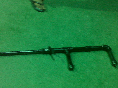

JUST WANTED TO KNOW WHICH AIR COMPRESSOR U USE
Unread postAuthor: HACKERZLORD007 » Thu Jun 09, 2011 1:17 am
HEY MATE
I JUST WANTED TO KNOW WHICH AIRCOMPRESSOR U USE BECAUSE MY EMERGENCY AIR COMPRESSOR CAN PUMP US 200 - 300 PSI MAX....MY GUN CAN HOLD A GOOD 600 PSI + BUT I CANT FIND A GOOD AIR COMPRESSOR..SO JUST ASKED...THNX MATE!!

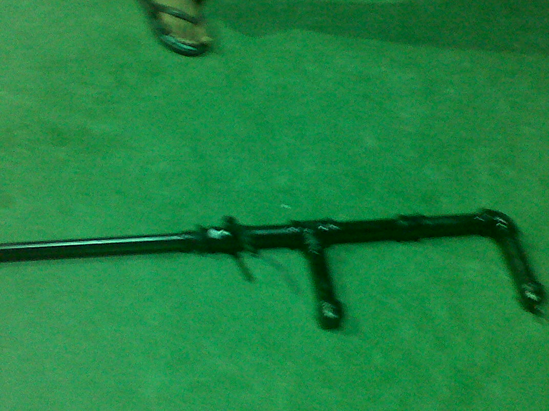

I tried searching google,yahoo and loads of other sites but all i get is heavy duty industrial air compressor!! The one i have is:
http://www.alibaba.com/product-free/216 ... essor.html
It can pump usually to 300 max but it kills the battery so usually i have to limit my shots to 200 psi which sucks....my gun is fully galvenized metal capable of doing 500+ psi but its a pity having a gun which is so capable but lacking the compressor!!!!
Help would be appreciated!

HERE IS MY PNEUMATIC AIR GUN....FULLY METALLIC CHAMBER WITH BLACK FINISH.....CAPABLE OF 500+ PSI BUT NEED A GOOD COMPRESSOR
