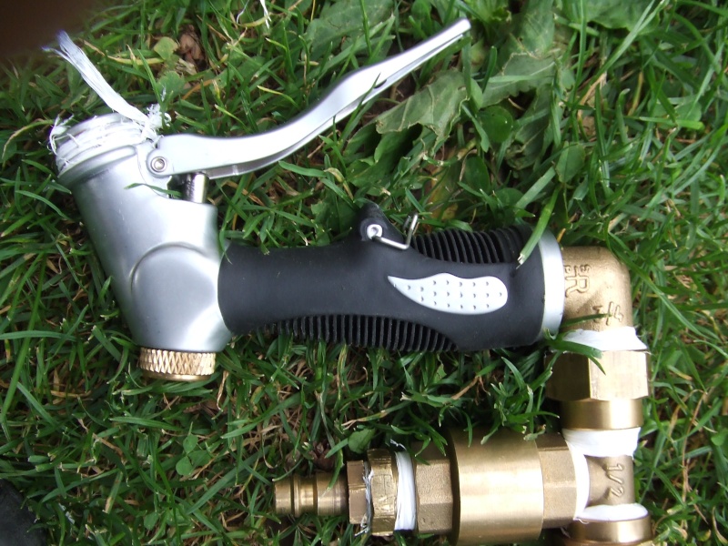

Unread postAuthor: Chinou » Sat Jun 30, 2012 9:52 am
Hello , This is my first post and i'm french with a bad English :D .
I love your achievement and I find it interesting that the language barrier
Pressure : 13 bar
caliber : for ball paintbal and the barrel is in inox
Reserve : galvanized tube (20x27 50 cm )
Picture:
Video:
PS: Sorry for my english (google translate ) .. :oops:

Unread postAuthor: jackssmirkingrevenge » Sat Jun 30, 2012 11:00 am
Welcome to spudfiles :)
Nice "standard" launcher, shame you went for the "garden hose nozzle" type pilot valve though. Replacing it with a ball valve (which could also incorporate the fill valve) would greatly reduce your pilot volume, improving performance.
Also, you'd be able to take advantage of the all-metal construction and go to higher pressures.

Unread postAuthor: Chinou » Sat Jun 30, 2012 12:24 pm
Thank you for welcome :)
It is true but this pac begins to be old ( errors in the sentence ? ). In addition i have a compressor of refrigerator for "high pressure"would require me to use .
Or else i would present one other pac later , thank you again for the council and sorry for the errors :?
