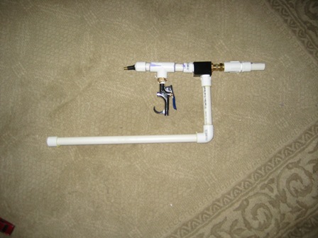

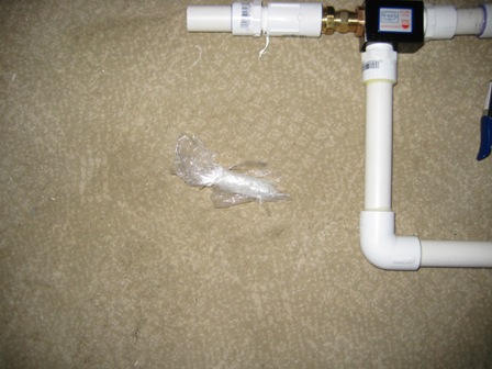

I just finished my QEV gun this morning. This gun is intended to be an "Indoor Gun" so I can use it inside without destroying anything (of coarse if you use a ball bearing for ammo then this gun would easily shoot though a wall) I designed a special type of ammo, made of Saran wrap, that can safely be shot inside. Originally I used Nerf bullets, but they cot ripped into pieces after being shot. I shot the gun at my foot at 80 PSI using my Saran wrap ammo and it felt like a paintball gun. There are no damage pictures. Also any advice is welcome, or ideas for future guns.
Do you think I need a longer barrel?
Side view

Unread postAuthor: jsefcik » Fri Aug 17, 2012 2:31 pm
PotatoEnemy17 wrote:I just finished my QEV gun this morning. This gun is intended to be an "Indoor Gun" so I can use it inside without destroying anything (of coarse if you use a ball bearing for ammo then this gun would easily shoot though a wall) I designed a special type of ammo, made of Saran wrap, that can safely be shot inside. Originally I used Nerf bullets, but they cot ripped into pieces after being shot. I shot the gun at my foot at 80 PSI using my Saran wrap ammo and it felt like a paintball gun. There are no damage pictures. Also any advice is welcome, or ideas for future guns.
how long is the barrel you have now?
you didnt give too much info, that like saying how long is a piece of string?

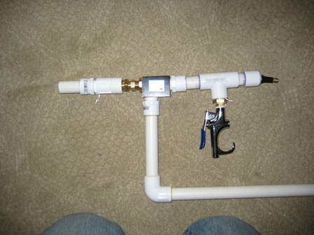

the other side
Saran wrap ammo

Unread postAuthor: mattyzip77 » Fri Aug 17, 2012 3:16 pm
If its meant to be shot inside leave it as is. Also I wouldnt reccomend shooting anything at yourself or anyone else for that matter. You could make your barrel about 2 feet longer and the way your chamber is set up your losing perelformance.Put the 90 degree elbow as close to the valve as possible using little or no pipe.

Unread postAuthor: jackssmirkingrevenge » Fri Aug 17, 2012 4:20 pm
Enormous pilot volume makes JSR sad :(

Unread postAuthor: PotatoEnemy17 » Fri Aug 17, 2012 4:33 pm
AircannonSweden wrote:
Nice gun PotatoEnemy17
Thanks! :P
jackssmirkingrevenge wrote: Enormous pilot volume makes JSR sad
Why? It's not semi-auto and it takes three pumps on the bike pump to get to 80 PSI. But I agree that it is wasteful.

Unread postAuthor: jackssmirkingrevenge » Fri Aug 17, 2012 5:24 pm
PotatoEnemy17 wrote:Why? It's not semi-auto and it takes three pumps on the bike pump to get to 80 PSI. But I agree that it is wasteful.
Big pilot volume = slower pressure drop when you pull the trigger = slower valve opening = less performance

Unread postAuthor: PotatoEnemy17 » Fri Aug 17, 2012 5:28 pm
Good point, I'll consider building a new manifold, but don't you think a slide valve would give me the best opportunity for low pilot volume? Or a 2/3 DCV because I planning on building one soon.
