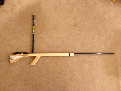

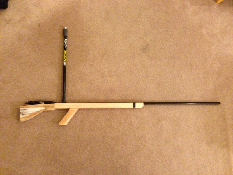

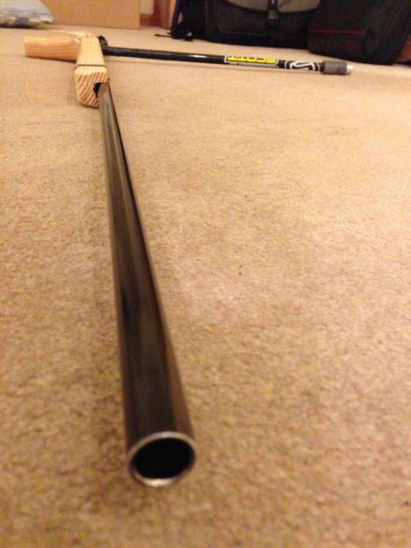

ok then here it is i have dreamed of making a fully automatic type big bore airgun for many years this is my first auto bigbore prototype the stock was lovingly thrown together as quickly as possible for low pressure testing and will be lovingly thrown away when the tape leaves and is replaced with epoxy and fiberglass at the moment i am running the setup on 120psi off a standard blowgun valve i have not made up my mind on what kind of valve i will use when i make the jump to 2000psi but ill cross that bridge when i get to it
Specs

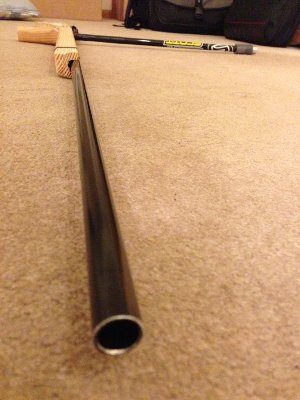

barrel
50cal 6061 aluminum 42in

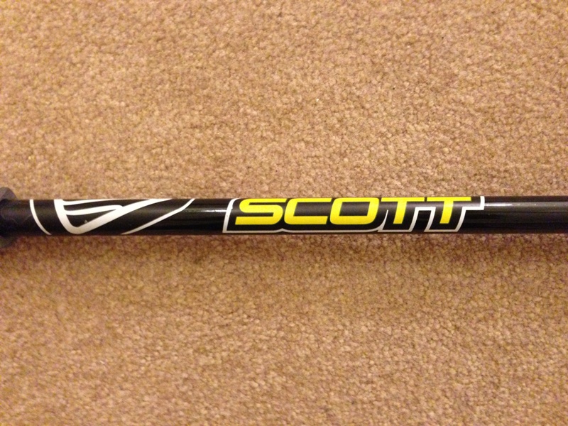

magazine is made out of a 6061 aluminum racing ski pole
as far as when i go high pressure i was thinking maybe a pressure washer valve any ideas on what i could use would be awesome
also something i want to add before i make the jump to high pressure is a single shot mode i have my own setup ready for that but any ideas are welcome and just incase you cant tell from the pics it is a basic gravity feed setup one step closer to the dream of making a 50cal vortex block :D

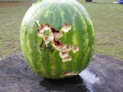

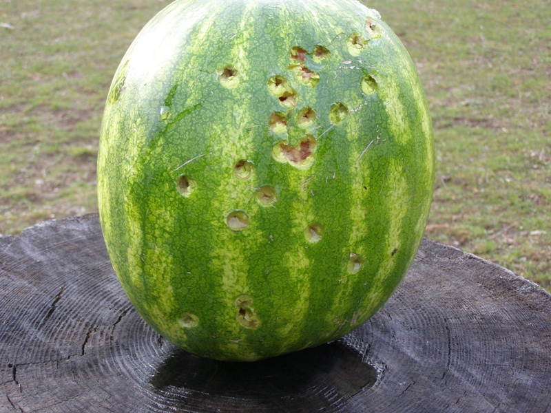

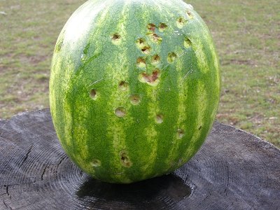

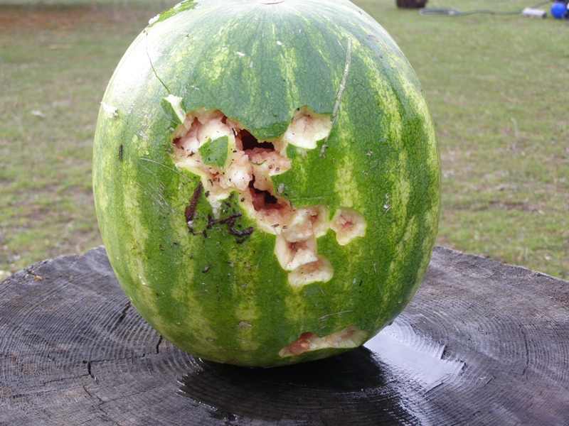

heres a video shooting a watermellon at 100psi im not sure if i need to clean up the feeding system abit or if i need better ammo ill figure it out

Looking good, HPA will absolutely murder that melon.
