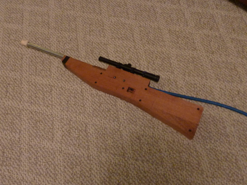

Well, sorry for the double post, but i have some updates :)
Here are some pictures of the gun in stock:

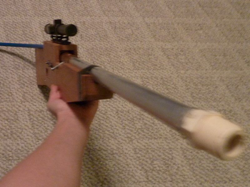

Unread postAuthor: 1nxtmonster » Sat Feb 01, 2014 1:08 pm
**UPDATE**
Air rig arrived, with a little bit of cleaning it works great! I re-arranged the internal washer assembly for a lower pressure range, now i can adjust from 50 to about 300 psi.
R-hop installed, I believe the term for what is occurring would be "over hop" (by about 6 feet at 150 feet)
R-hop un-installed, back to heat shrink tubing. Works like a charm at 150 feet with 120 psi.
Running a higher pressure, this thing is loud! Silencer helps a lot with that.
And finally, would a new topic for the finished thing with a final video be okay?

Unread postAuthor: 1nxtmonster » Sun Feb 02, 2014 9:05 am
@ bravootome - my "hop up" right now is very gently rubbing the bb, not really much at all.
@ lazyboy - The tank is about 3/4 empty, and I've done 400 shots.
