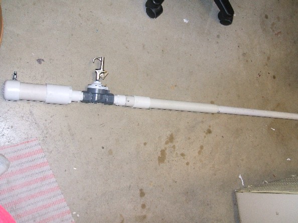

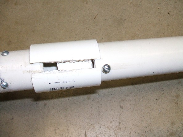

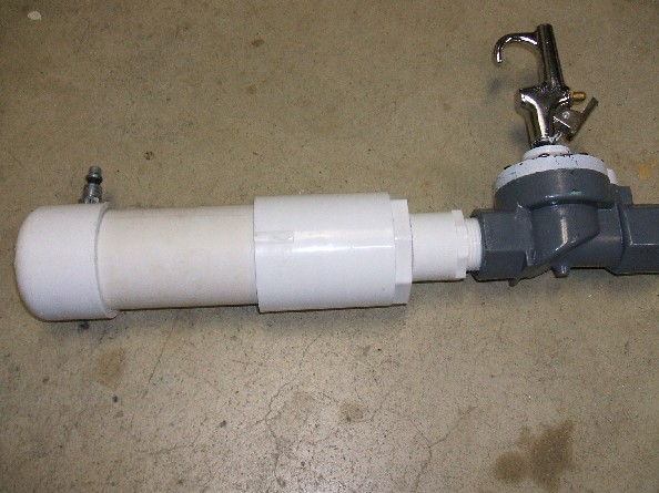

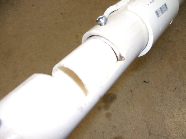

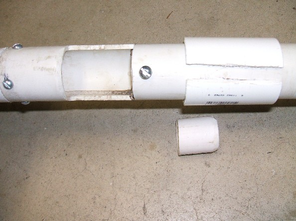

A basic sprinkler valve gun that's capable of about a shot per 3-4 seconds. I have a few shell or it, just pieces of 1" SDR 21 that are sharpened. The barrel is also 1" SDR 21, so the shells aren't launched. Stick the shell into a potato, put it in the breech, slide the sleeve down, twist to prevent air loss, shoot, slide the sleeve up, and shoot again to eject the shell. I think it's pretty good for a spare parts gun. :D
  • 0
The full gun
Close and shoot.
Slide it down
Shell in the breech
Open breech
The gun's chamber

Unread postAuthor: homedepotpro » Wed May 30, 2007 11:47 pm
nice gun how does the back of the bolt seal to prevent air loss

Unread postAuthor: noname » Thu May 31, 2007 12:04 am
The isn't a bolt, and not much air leaks out, maybe a tiny bit. The sleeve is a bored out 1 1/4" coupler.

Unread postAuthor: jackssmirkingrevenge » Thu May 31, 2007 1:40 am
would be useful for pre-loaded shotshells. I take it the spent shell ejects by gravity?

Unread postAuthor: noname » Thu May 31, 2007 7:13 pm
Nope. The breech is facing upwards so loading is easier. It takes a couple seconds to refill the chamber, so when it's about half full, I slide the sleeve up and shoot, which ejects the shell.
