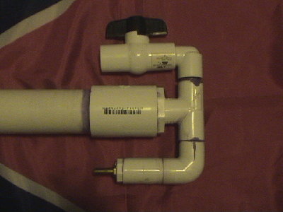

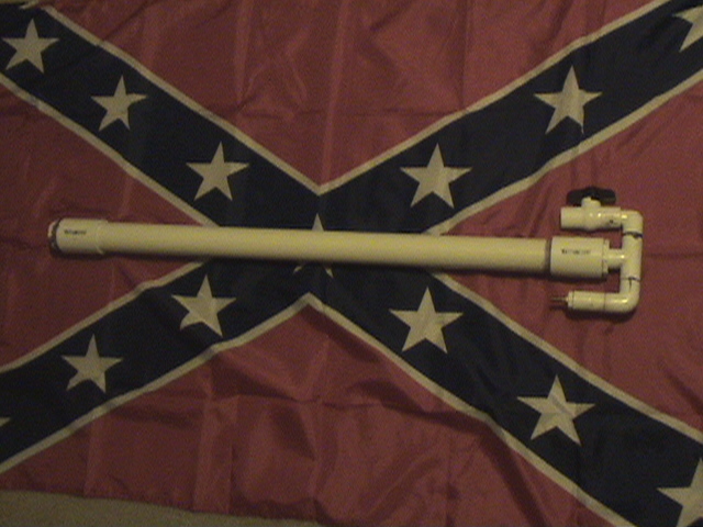

STORY TOME!! This cannon is my 6th. I named it the PVC_01, which stands for Piston Valved Co-axail and the 01 cause its my first co-axail.
Specs:
Chamber- 1.5"x3'
Barrel- .75"x2.75'
Piston- 1.5" solid type II pvc rod bored out in the back for lowering weight
Seal- Shower/bath liner($5 for 5'x1')
Pilot valve- 1/2" ball valve
Fill valve- Schrader valve
BTW i just finished gluing this cannon about 10 min ago, and was feeling impatient(sp?) so i posted it, as a result, no damage pics yet.
That about sums it up. What do you guys like/dislike?
  • 0
The whole gun

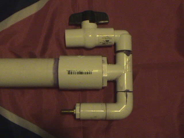

The fill/pilot assebaly

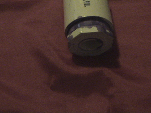

The buisness end

Unread postAuthor: mopherman » Sat Jul 07, 2007 5:03 pm
very ince. how are you going to searvice the piston? i would have use a metal ball valve though

Unread postAuthor: lukemc » Sat Jul 07, 2007 5:45 pm
major mistake! you cemented the piston inside. and this means that when something goes wrong (which its bound to do) you cant fix it without cutting off the bushing. i would suggest change to a threaded adaper before anything realy bad happens. trust me itll be worth it in the long run

Unread postAuthor: origin unknown » Sat Jul 07, 2007 5:58 pm
Nice coaxial. If your launcher ever craps out on you, you can just cut the gun open and take the piston out and build a new gun with a threaded female adaptor, and a threaded male plug.

Unread postAuthor: rednecktatertosser » Sat Jul 07, 2007 9:04 pm
@Big-mac: yes i am taking this to the Texas meet. We will be sure to take lots of pics, and possibly some vids for all too see. Dont worry, we'll launch one for you! :wink:
Yeah, if anything goes wrong im gonna cun the end section off of the chamber and just glue a threaded adapter onto that, but like i said this was just a spare parts cannon, save for the ball valve. and I didnt think about piston service while throwing it together.

Unread postAuthor: Modderxtrordanare » Sat Jul 07, 2007 10:06 pm
This quote from a while back suits that gun just fine, since I couldn't find the one I was looking for. :(
jackssmirkingrevenge wrote:
Modderxtrordanare wrote:Dammit, you edited in some of your efficiency nazi'ism.
excuse the delay, I was still in shock from the enormous amount of wasted air, the pictures burnt my eyes :shock:
:P :wink:
Cut down on that pilot volume for Pete's sake. :wink:

Unread postAuthor: Modderxtrordanare » Sat Jul 07, 2007 10:37 pm
Same thing as an over under piston, and my over-under piston gun has less pilot volume than that thing. (When it's in proper working condition)
I originally thought you used PVC_01 because of this. 8)
