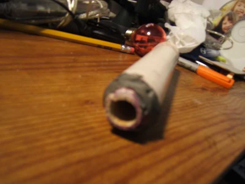

this is my pocket pneumatic that I have had for a few months, the barrel is 1/2"cpvc, the body is 3/4 pvc, it is acuated and filled by schrader, it often fails to shoot and is very weak, sadly it is so weak that it can't shoot lose fittin objects, but all is not lost it tightly fits nerf darts and shoots them with satifactory power

nice. but is it a piston/diaphram or something else? if its is a piston or diaphram i can see how its piloted.

On that scale, you need to be running at least 200 psi+ for decent power. Still, nice and compact launcher, good to see more small co-axials around :)

Unread postAuthor: iknowmy3tables » Tue Jul 24, 2007 1:12 pm
thanks did I mention its a piston, with a bike tire patch as a sealing face

No you didnt, but I made a guess that it was. Would neoprene not work better to seal it because it helps if the barrel isnt 90 degrees perfect. But if it is, it isnt an issue. :wink:
Maybe your gun isnt very powerful because there isnt enough chamber space because your C:B ratio is 0.5:1, which is pretty small!

Unread postAuthor: jackssmirkingrevenge » Tue Jul 24, 2007 1:23 pm
Also, if it fails to shoot, then your piston probably isn't tight enough in the chamber, or it has too much friction.

Unread postAuthor: iknowmy3tables » Tue Jul 24, 2007 2:59 pm
@ spud yeti, what do you mean no I didn't
@at Jack yeah thats why I pour oil and goop down the barrel frequently
