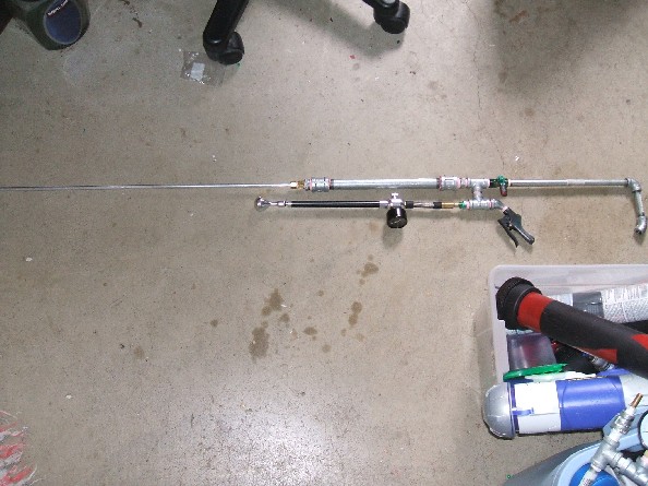

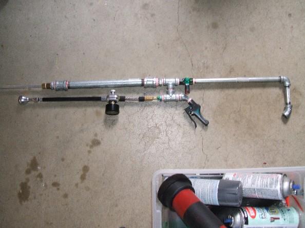

Just a steel coaxial, made for shooting airsoft BBs. I was planning to put the shock pump inside some PVC and attach it to the chamber, along with a scope, but never really did. I run it at 400 psi, and according to GGDT it shoots at 2232 fps. I highly doubt that, but even using extremely crappy figures in GGDT (huge amounts of dead space, pilot volume, piston mass, etc.) it still said it shot at at least 1362 fps.
I'm not sure it if actually does ahoot supersonic; all I know is that it makes a loud CRACK! louder than a .22 caliber rifle.
I can pilot it through the schrader valve or the ball valve, but I use the blowgun because it's mmore "trigger like."

very cool. did you drill out a compression fitting to get it coaxial? what is the chamber diameter?

Unread postAuthor: noname » Fri Jul 27, 2007 2:47 pm
Yes, I drilled out a compression fitting. The chamber is 1/2" Sch 40 steel.
Edit: Forgot to mention, the barrel support is a washer with holes in it. Me, being extremely stupid, poked the extrmeely hot washer to see if it was extremely hot. It was. Now I have the faint impression of a small washer imprinted in the end of my finger, along with a ring shaped blister. :D

Unread postAuthor: mopherman » Fri Jul 27, 2007 2:50 pm
what is the black thing under the chamber?
EDIT sounds like the time I dipped my finder in a hot glue mold. my hand blisterd for weeks
EDIT EDIT is it a piston or diaphram?

Very nice work... 400 PSI is intense. I didn't see any numbers in your first post, so could you possibly tell me how long the barrel and chamber are (sorry if I missed it...).

Unread postAuthor: SpudBlaster15 » Fri Jul 27, 2007 7:29 pm
VERY clean build noname! I really like this gun. I see you used some of the parts from your (green) steel hybrid. :D
A gas cannot propel a projectile to velocities greater than it's own speed of sound.

Unread postAuthor: VH_man » Fri Jul 27, 2007 7:51 pm
i may just be a party pooper but arent blowgun's rated to 90 PSI?
cause hell, if they are rated higher im building myself one of them........
you should mount a cheap airgun scope or something. even some kind of sights. use .3 gram PHX hig-grade bb's too. youll get accuracy...... alot of it.....
how long is that barrel? its out of the picture...........

Unread postAuthor: iPaintball » Fri Jul 27, 2007 8:39 pm
Very nice rifle noname! It's very clean and well constructed. ME LIKEY! :D Did you use a piston or a diaphragm? Also, what did you use as a barrel? Brakeline? I'll bet it's powerful too. I get about 700 fps out of my QEV powered pistol. It can shoot through thin sheet metal with .20g BBs (I have holes in my gutter to prove it!), so I can't imagine what that would do... If only you could pressurize it with helium...

Unread postAuthor: noname » Fri Jul 27, 2007 8:44 pm
I was going to make a bunch cooler, with a scope mounted on top, a hand made grip on bottom to hold the shock pump in place, a bipod, a flat black paintjob, etc. But I chose not to.
The black thing under the chamber is the shock pump. It takes quite a bit of elbow grease to get it that high (along with about 7 or 8 minutes), but I can manage it.
Origin Unknown, your comment was very surprising to me. I guess I just wasn't expecting it?
The chamber's 1/2" x 10," but about 11" if you count the couplers. The barrel is 9/32" brass brakeline (realized after I mailed it that I did still need it, redneck, lol).
Spudblaster, you'll see green parts on many guns involving metal that I make. I have a lot of them left over.
Potatoflinger, how much "skill" does it take to screw fittings together?
All it really was was a design on paper, a parts list, a hell of a lot of teflon tape (pink teflon, if you didn't notice), drilling a hole in the compression fitting.
VH man, you're talking to someone who ignited an 8x hybrid mix from less than a foot away, feel free to use a blowgun if you dare.
The piston is just a piece of 1/2" aluminum rod with a circle of rubber JB welded to the front.
