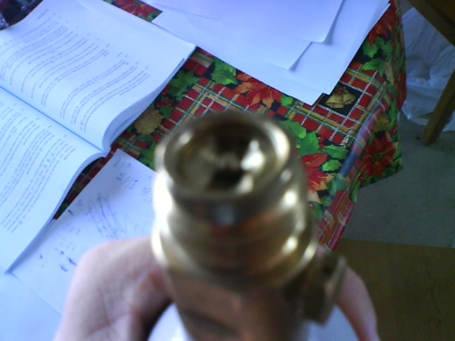

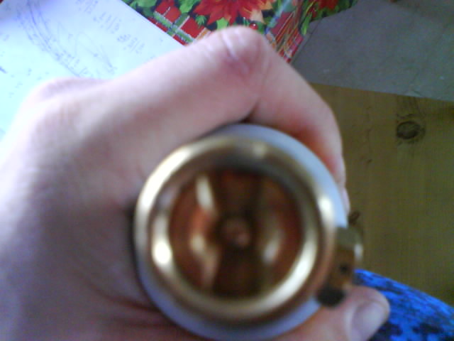

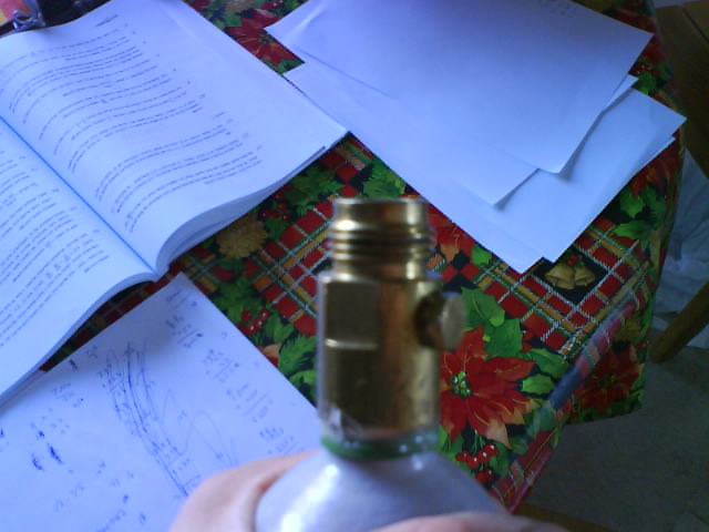

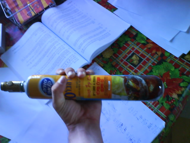

i buy the soda-club tank that include 260g CO2.
do you know what i can do with the open of the tank? how can i connect it to iron chamber? i don't know how the soda-clab tank looks in other countrys, here is a few pic's, not so good quality

Unread postAuthor: DYI » Tue Aug 28, 2007 10:50 am
Hmm... maybe you should have figured out how to use it before you bought it.
What kind of threads are those? If you know that, you can probably find a regulator for it.

Unread postAuthor: iPaintball » Tue Aug 28, 2007 10:55 am
I don't reall yunderstand our question very well. Do you want to use it as a chamber? Or do you want to pressurize your cannon with it?
BTW, those are just standard CGA 320 threads.

Unread postAuthor: Orpackrat » Tue Aug 28, 2007 12:10 pm
That looks like a little paintball tank, get one of these:
http://cgi.ebay.com/Purple-Tank-Adaptor-Bottomline-Duck-Bill-Standard_W0QQitemZ170143821296QQihZ007QQcategoryZ16051QQssPageNameZWDVWQQrdZ1QQcmdZViewItem
It has 2 outlet ports and comes with a plug for one. Put some Teflon tape on the plug and screw it in one of the outlet ports and use the other for your expansion chamber. The outlet threads on the adapter are standard 1/8" pipe threads. For better efficacy without wasting Co2, put a metal ball valve before the expansion chamber to fill it and close off the tank supply when full. And another metal ball valve to fire.
