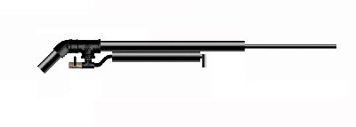

Unread postAuthor: jackssmirkingrevenge » Mon Sep 03, 2007 7:05 am
Mitchza89 wrote:Do you have any pictures of the gun itself?
here it is, this is the breech end:
This is what the internals look like:
However it became apparent that for the barrel length, I had made the chamber too small, so I doubled the volume like so:

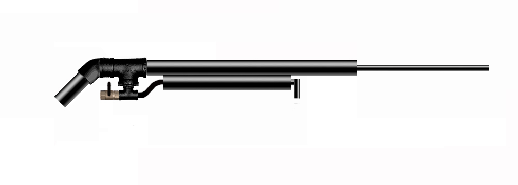

Unread postAuthor: Mitchza89 » Mon Sep 03, 2007 7:14 am
Wow. Thats really well made mate. Would have taken a while not to mention alot of planning to build.
The one I'm building will be like a shotgun. It will be like a Coax in a sense because the chamber will be around the barrel but the barrel extends back into a 1/2 brass tee to make a Tee valve. I'm doing it this way so I can attatch the pump straight to the chamber so it's much as much of a conventional bb gun as it can possibly get.
  • 0
Its a bit out of proportion but the chamber is 1/2in that goes into 1/2in T, that goes into a 15mmx6mm nipple, straight into a 6mm tee.
