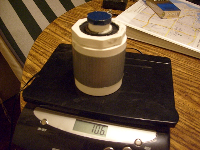

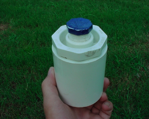

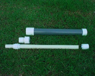

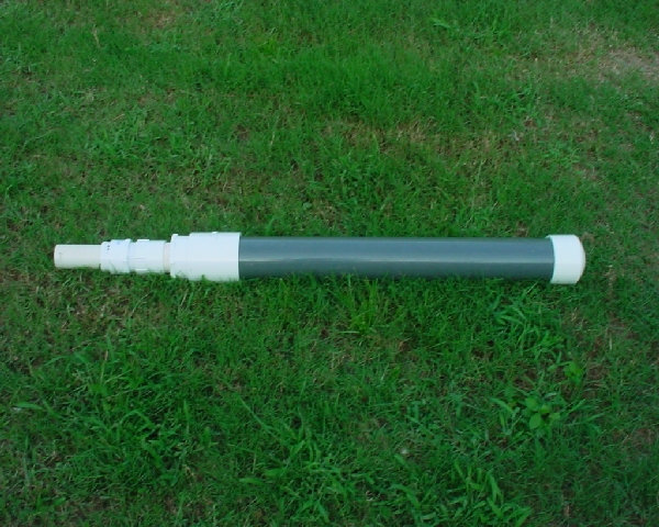

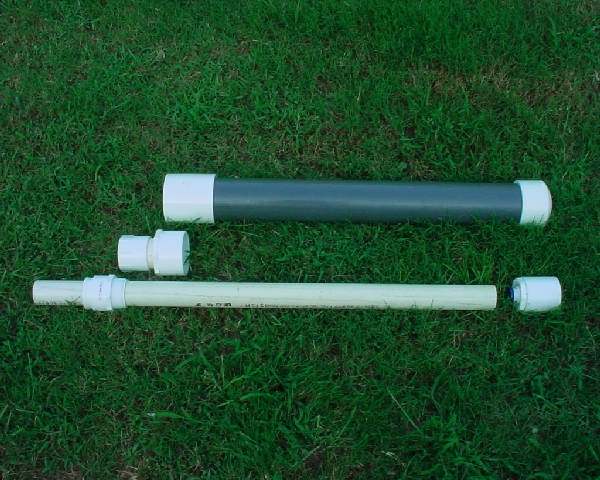

This gun came about from a eureka moment I had earlier today. I have pic's of my piston below. The gun will be a coaxial barrel sealing piston design and I'm wondering if you have ever seen of a piston like mine and if it worked ok or not.
My gun has a 3" SCH80 chamber and 1.5" barrel. I'm using a 2" reducer bushing and coupling as a piston. The way the reducer bushing is made, the 1.5" barrel slides right into the groove in the bushing. I've filled this groove with RTV Silicone and I'm wondering if it will work to seal the barrel from the chamber. Also how far should my piston be allowed to travel for best performance?

Piston before RTV Silicone and Tape
10.6 oz piston with RTV silicone and tape.
Basic design, yes it has a very short barrel.. don't worry it's temporary.
Exploded view

The piston may be a little heavy. The silicone will work, as long as it is completely smooth to allow for a complete seal. As far as piston travel, a lot of members here say that .25% of the barrel's ID is the way to go.

A little heavy, as in it will tear the gun apart or too heavy to slide back and forth? I have a rubber bushing (the type they mount car bodies to the frame with) that I'm planning on using as a bumper.

The piston is probably too heavy to move properly. It will probably still move, but it will move slow and will be less efficient than a lighter valve.

A heavy piston will be a little more abusive on the gun, so make sure you have a good bumper, but it wont have a significant impact on performance. Although if you are concerned you could probably cut a few inches off the back of the piston.

I'm concerned that the blue cap on your piston is really going to hurt performance as it's going to dramatically reduce your flow into the barrel - isn't there some way you can plug that hole with something flush?

Unread postAuthor: Dornep » Sat Sep 08, 2007 11:40 am
I'm sure I could make it flush but I'm concerned about using other barrels with this piston since it won't seal unless the barrel is 1.5".
I bought a 2nd coupler and a 2" plug that will work the same way but I will have to find another way to seal it. But I will be able to use different sized barrels if I do it that way.

Unread postAuthor: jackssmirkingrevenge » Sat Sep 08, 2007 1:38 pm
Ideally you want a flush piston with a disc of rubber bolted on over its whole sealing surface, that way you can use any size of barrel you want.
