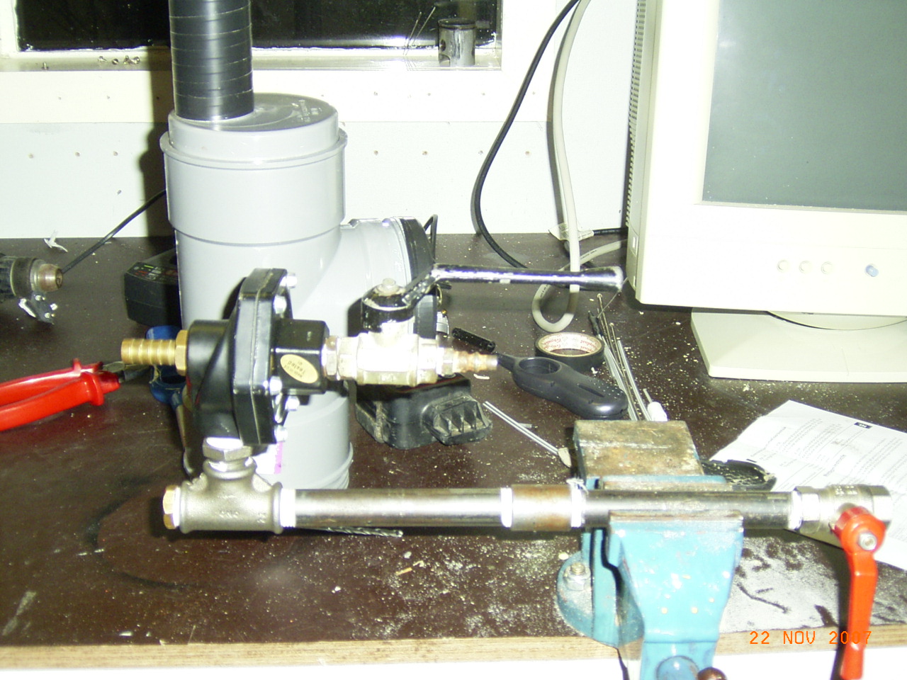

But first i maded a test-setup, because i didnt understand what type of valve i was dealing with, it seems to be a Quick-exhaust valve though, it has a circular rubber flap inside and works just as the schematic you have on wiki about it.

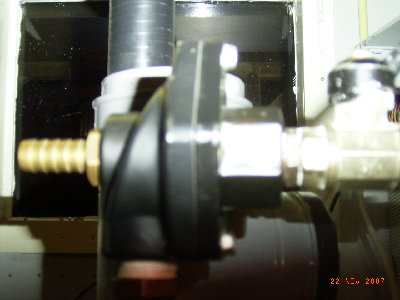

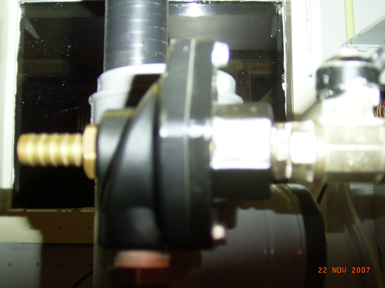

a fast release valve
the test-setup for my fast release valve
(hence my basic combustion gun in the back)

The valve you have is most commonly known as a QEV ( Quick exhaust valve) and has previously been used (quite a lot) by European spudders because they are easier to get than sprinklers.
To answer your questions:
1: a 1:1 volumes ratio is normally the best option for pneumatics, but if you use high pressures (200+) then a smaller chamber volume can be used (effectively).
2: As long as your fittings are all pressure rated (if they are copper, then YES) and have been connected properly, then the valves han handle pressures up to, and past 300PSI. I am not saying it is safe, but I have not have one failure (yet) at pressures of 400PSI.
3: To fill, a schrader (bike) fill-valve is best used in combination with a ball valve to prevent the valve from actuating. The best way to actuate the valve would be with another ball valve used as a trigger, or a blowgun.
Hope that has helped a bit, if more questions are required about QEVs, feel free to PM me.

I don't think you'll need the ball valve. That does look like a QEV, and it would make a great pilot valve for a piston valve. I see your dad said no??? For the ratio, i'm not good at math, but the chamber should deffently have more area then the barrel. Hang in there the anwsers to your questions will get answered. Welcome to Spudfiles.

Can some1 do me a favor, and take a gues what the values should be for my QEV, cause i dont realy understand it. At 10 bar (150psi) i get a speed of 50m/s (150ft/s) wich is just lame :? if you compare it to similair guns in showcase
some specifics about the QEV that i know:
3 times 1/2" threaded entrances
inside pilot diamater is around 1"
inside exaust diamater is around 1"
a round rubber flap of like 3" between pilot and exaust.
but then i have no idee what to fill in and where :S

For a pneumatic at 120 psi, the MOST EFFICIENT, and therefore MOST POWERFUL C:B ratio, for a given chamber size, is roughly 0.2:1.
This is not a guess. This is not something I have heard from someone else on the forum. This is pure fact, taken from experimentation with GGDT, the most accurate pneumatic cannon physics modeling program in existence. It is frustrating how many times I have had to write this in the past few days.
1.5:1 is an awful waste of air, as is 1:1. The ONLY time that you need a ratio bigger than 0.5:1 or so is when you can't make the barrel any longer. And C:B is normally used, Maxus, not B:C.
As for the other questions, the valve looks like a diaphragm QEV, what amounts to a more efficient and premodded version of a sprinkler valve.
We can't model it in GGDT without ALL of the specifications for the valve, but your design will be fine. Could use a bigger barrel though.
Also, I don't encourage this, but any copper pipe and fittings that are not for drainage only and under 5 cm in diameter can easily withstand well over 50 bar. Their safety factors are extreme, and they tend to burst at over 200 bar. You don't need to worry about over pressurising them unless you are dumping unregulated high pressure gas cylinders into them.
