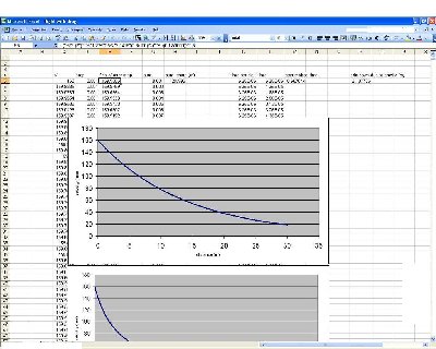

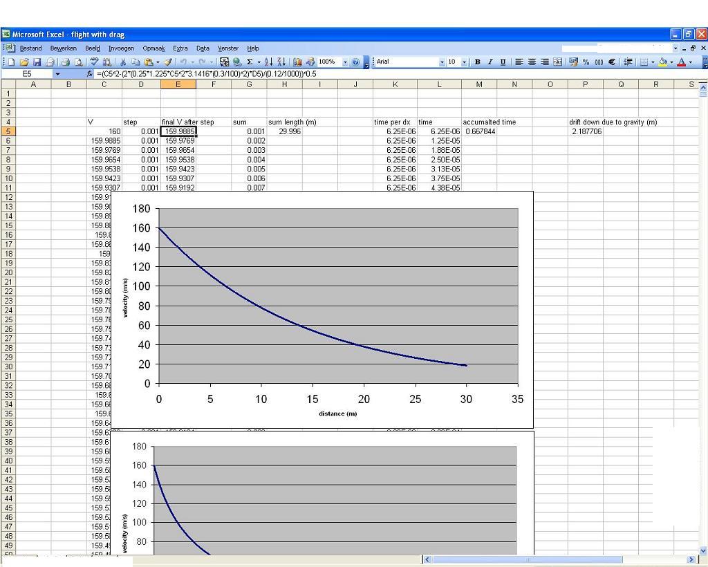

Unread postAuthor: Antonio » Mon Dec 17, 2007 4:22 am
jackssmirkingrevenge wrote:150 feet doesn't sound like sufficient distance for a streamlined and reasonably heavy projectile to lose so much velocity, I would suggest shooting at plywood/cardboard sheets before trying it out on people.
Yeah you never know how fast they really go. At this speed its not very responcible to shoot at ppl. Btw the way to calculate the decrease in speed over a distance is to use: Drag force=0.5*Cd*density air(1.225)*V^2*frontal area > F=m*a > a=F/m >where the force is the drag force. Btw the Cd(drag coefficient) for a sphere is about 0.5. Then if you intergrate this over the distance which it is shot at u can calculate the final velocity which will be about 1/8 of the original over a 30m for example. I have done these calcs on excel and its a kinda heavy document(6mb) bc I tried to approximate it as accurate as possible. I am telling u 150feet=50m> at that range drag is Really significant.

Unread postAuthor: jackssmirkingrevenge » Mon Dec 17, 2007 5:44 am
I understand the calculations involved but still, an 87.5% decrease in velocity for such a projectile over 30 metres seems far too much, consider that the long streamlined form is a lot more aerodynamic than a sphere.
