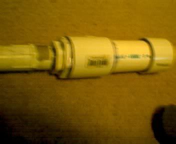

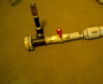

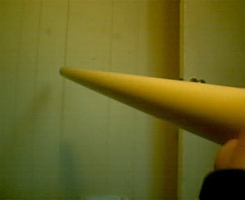

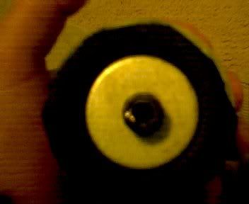

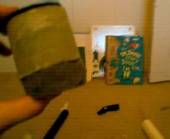

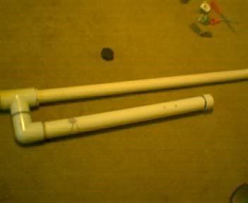

Ive been working at this for a while and Im finnally almost done.Today I went to lowes to get some 1.5in sdr21 and got a ten foot stick for 4 bucks.I also got some other stuff to finish it.The chamber is 32in of 2in pipe.And the barrel is five feet of 1.5in sdr21.
heres some pictures
The piston
Sealing face
Piston with bumper
Modded plug with exhaust assembly
secondary champer to help piston seal
The barrel
The full cannon put together
I didnt put it in the show case section because it is not yet finished.Any comment/suggestions are highly appreciated.If you want more info on the piston visit this link

Okay sorry for the double post but I finished this thing today and it was really powerful :twisted: .I have made piston valves before and I would like some comments on how I could make the valve even better and more powerful than it already is.
by the why I dont know why but this valve is very quiet for some reason.All my other piston guns have been very loud. Is this a bad thing.
And a GGDT on it would be nice too.
  • 0

Unread postAuthor: elitesniper » Thu Jan 24, 2008 9:11 pm
i think your pilot volume is way to big
  • 0

Unread postAuthor: bigbob12345 » Thu Jan 24, 2008 9:21 pm
elitesniper wrote:i think your pilot volume is way to big
What do you mean I have like no pilot volume at all its just a cut down plug that goes straight into the tee.You might mean that thing at the back of it thats a secondary chamber that I use to seal the piston beacause it doesnt seal when I just pump into it with my bike pump.
