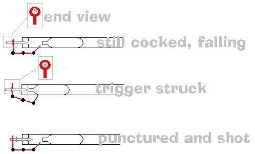

Unread postAuthor: lockmanslammin » Tue Mar 04, 2008 1:05 am
Cool idea, I imagine that when you were thinkin' it up, you thought the part where you drop it down the barrel to fire it was part of the coolness, seeing as how that is what real mortors are like. Although I agree with previous posters, that it wouldn't be enough to puncure it. Although, if you still wanted it to work that way, you could use the spring accuated nail for the piercing, but have the trigger be set off by the accual canister as it is almost too the nail. here is a simple drawing....
<a href="http://s117.photobucket.com/albums/o75/lockmanslammin/?action=view&current=quickdiagram.jpg" target="_blank"><img src="http://i117.photobucket.com/albums/o75/lockmanslammin/quickdiagram.jpg" border="0" alt="quick diagram"></a>
obviously the levers and such would have to be housed in something and it would be more complex than this but do you get the idea?
Good luck, lock

Unread postAuthor: OuchProgramme » Tue Mar 04, 2008 7:31 pm
lockmanslammin wrote:Cool idea, I imagine that when you were thinkin' it up, you thought the part where you drop it down the barrel to fire it was part of the coolness, seeing as how that is what real mortors are like. Although I agree with previous posters, that it wouldn't be enough to puncure it. Although, if you still wanted it to work that way, you could use the spring accuated nail for the piercing, but have the trigger be set off by the accual canister as it is almost too the nail. here is a simple drawing....
Good luck, lock
With just the weight of the canister, it's not going to be able to puncture a hole. If added with a swinging mechanism, centripetal force would be have enough force to break through the canister.

Unread postAuthor: Rokmonkey » Tue Mar 04, 2008 8:18 pm
A couple friends and I have tried this out, after spending forever to get the nail lined up with the Co2, it wasn't even that good, It wouldn't puncture straight and the round would always shoot off wonky, and because of the small hole it had some serious propulsion after it exits, so that round will go crazy.
We made Co2 powered cars back a while as well, those things never went straight either even with a guide wider. Suggestion, don't even bother putting the Co2 in the round, come up with something else.
