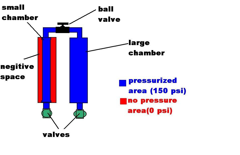

maybe you should try making on of the chambers smaller like 1" or 1.5" and put a 4" pipe over it so it is symmetrical. then you could use the big chamber or both of the chambers for your distance and your small chamer alone for your sons practice.
just an idea :lol:
  • 0

Unread postAuthor: base45 » Mon Mar 10, 2008 2:27 am
this is referring to my post right above jsr's
<a href="http://s251.photobucket.com/albums/gg316/milesjohnson93/?action=view&current=chamberidea.jpg" target="_blank"><img src="http://i251.photobucket.com/albums/gg316/milesjohnson93/chamberidea.jpg" border="0" alt="chamber idea"></a>
should make more sense now :shock: (ms paint is annoying!)
