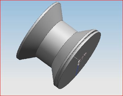

Unread postAuthor: DonTheLegend » Sun May 11, 2008 6:01 pm
Modified piston, along the lines of what gippeto suggested. Reduces weight without increasing the pilot volume.

Unread postAuthor: mike1010 » Mon May 26, 2008 3:10 am
what design program did you use to make that image it looks great?
  • 0
mike1010
Sergeant Major
Sergeant Major
Posts: 197
Joined: Thu Jun 21, 2007 6:38 pm
Reputation: 0
Unread postAuthor: DonTheLegend » Mon May 26, 2008 10:29 am
Thanks, we used NX 5 to draw everything, and then we just took images of the screen with snipping tool (Vista only, I think).
