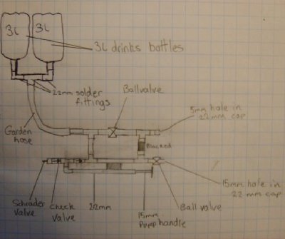

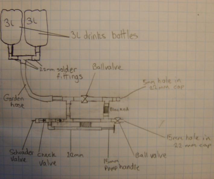

Plans for water cannon are here. I decided to go to the experts regarding advice, but you can see the more detailed (and neater) plans. I may try to get a rubber bladder tank so that I can get constant pressure instead of having to keep pumping. That would also mean I can pressurise from the municipal water system![/url]

Unread postAuthor: Biopyro » Thu Jun 12, 2008 5:47 am
Ok well cider is the only source of 3l bottles, so I'll have to look into that!
I'm gonna go with just an air pressure design because using rubber tubing is too complicated... for now.
Unfortunately 22mm pipe doesn't fit in the drinks bottle like I thought, so I'm going to heat some flexible hose and fit it around the bottle, hopefully it'll be watertight.

Unread postAuthor: Biopyro » Thu Jun 12, 2008 11:18 am
I tried that and I couldn't get the tubing I have to stretch. When I jammed the 22mm pipe in the bottleneck though, it was a perfect fit. I put it up to >100psi and it wouldn't budge on it's own (no swelling or other side effects too). I'll secure it as if it's the male part of a compression fitting, then it'll be no problem.

Unread postAuthor: THUNDERLORD » Thu Jun 12, 2008 12:06 pm
@Biopyro, Those plans look great.
You should make a seperate post for that.
There's no showcase for water cannons. Guess it would go in pneumatics if that's allowed(?)
