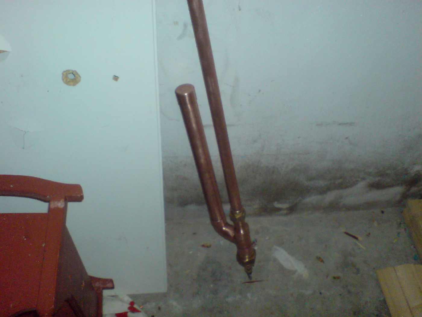

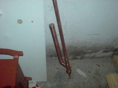

Unread postAuthor: SpudFarm » Mon Jun 16, 2008 10:41 am
could this be something for you?
good at 500psi if you have the pump.
  • 0

Unread postAuthor: MrCrowley » Mon Jun 16, 2008 2:10 pm
Cost far too much. That's 40mm copper, no?
  • 0

Unread postAuthor: SpudFarm » Mon Jun 16, 2008 2:59 pm
he can allways make it smaller MC
  • 0

Unread postAuthor: MrCrowley » Mon Jun 16, 2008 11:18 pm
Yeah but you can only buy copper in 6m lenghts as far as i'm aware and according to plumbing merchants. So you're looking at $150 on 6m of 20mm copper.
