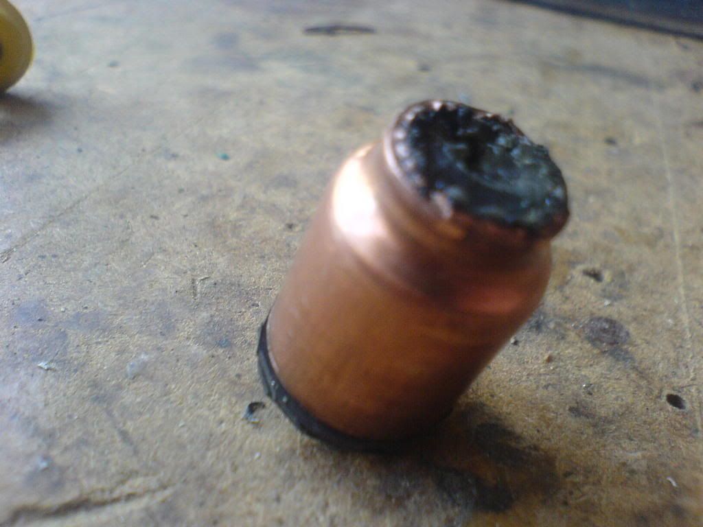

Unread postAuthor: hyldgaard » Tue Jul 01, 2008 6:45 am
Damn i feel lucky not to have these apparently very normal problems.. i use two layers of bike innertube and it works flawlessly for me at 500psi :) also i dont use any kind of bumper and i have no problems at all :)
EDIT: picture of my piston, back side up (if its to any help)
