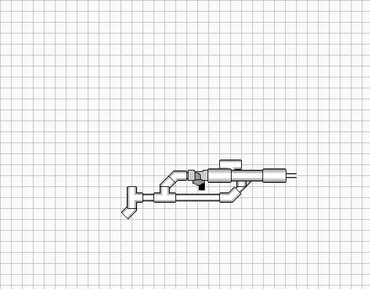

Unread postAuthor: frankrede » Thu Aug 14, 2008 12:10 am
<a href="http://s30.photobucket.com/albums/c325/redensekjf/?action=view&current=design.jpg" target="_blank"><img src="http://i30.photobucket.com/albums/c325/redensekjf/design.jpg" border="0" alt="Photobucket"></a>

Unread postAuthor: brogdenlaxmiddie » Thu Aug 14, 2008 12:15 am
should you what? Build it? why not?

Unread postAuthor: frankrede » Thu Aug 14, 2008 12:21 am
Should I build it? Does anyone know if 1" pipe will suffice for a chamber?

Unread postAuthor: starman » Thu Aug 14, 2008 12:22 am
Why not? If I see that correctly, you have a coax tank supplying the sprinkler via the bottom pipe and no piston. Ooor do you have a piston in there, the sprinkler is the pilot and the bottom pipe not holding any air?

Unread postAuthor: brogdenlaxmiddie » Thu Aug 14, 2008 12:35 am
Imma need some identification of parts....

Unread postAuthor: starman » Thu Aug 14, 2008 12:45 am
frankrede wrote:Should I build it? Does anyone know if 1" pipe will suffice for a chamber?
I'm assuming a piston in there...if barrel is roughly to scale with the tank, yes. Are you shooting airsoft?

Unread postAuthor: frankrede » Thu Aug 14, 2008 12:55 am
Oh no its a sprinkler valve cannon, the barrel has a full length silencer.

Unread postAuthor: starman » Thu Aug 14, 2008 1:02 am
frankrede wrote:Oh no its a sprinkler valve cannon, the barrel has a full length silencer.
Oh I gotcha. I think you'll have plenty of tank, unless you're planning on shooting 5 lb uranium darts or something... :wink:
I think it's a neat and compact little design.

Unread postAuthor: frankrede » Thu Aug 14, 2008 1:08 am
and for the trigger I am going to have a 90* with a pop off valve

Unread postAuthor: CasinoVanart » Thu Aug 14, 2008 1:27 am
I think the fact that it has a full length silencer tells you that you MUST make it :) Looks very cool indeed.
You will recieve lots of good Karma too, saving people from the noise of the launcher :D

Unread postAuthor: trollhameran » Thu Aug 14, 2008 2:53 am
looks good, I say go for it.
What did you use to draw the design?

Unread postAuthor: TwitchTheAussie » Thu Aug 14, 2008 3:25 am
I love it. Loks ergonomic :D

Unread postAuthor: rna_duelers » Thu Aug 14, 2008 6:35 am
By the way,drop the idea of the pop off valve for fireing...The suck for that job plain and simple.
Build it!

Unread postAuthor: frankrede » Thu Aug 14, 2008 6:50 am
I think I will build it, I have a fat paycheck coming up
here's the program
http://www.airsoft-online.8m.com/Programs/
click the last one. Its really easy to use.
@RNA, why do they suck?

Unread postAuthor: rna_duelers » Thu Aug 14, 2008 6:53 am
From experience,they don't work so well.
