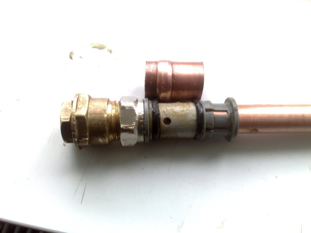

Unread postAuthor: trollhameran » Sun Aug 17, 2008 10:08 am
[img][img]http://i256.photobucket.com/albums/hh172/trollhameran/17082008753.jpg[/img][/img]
Thats the seals and what not, There are four of those holes positioned around the pipe, I decided it would be easier to have the slide move along the o rings rather than fixing the o rings to the slide and having them move along the pipe.

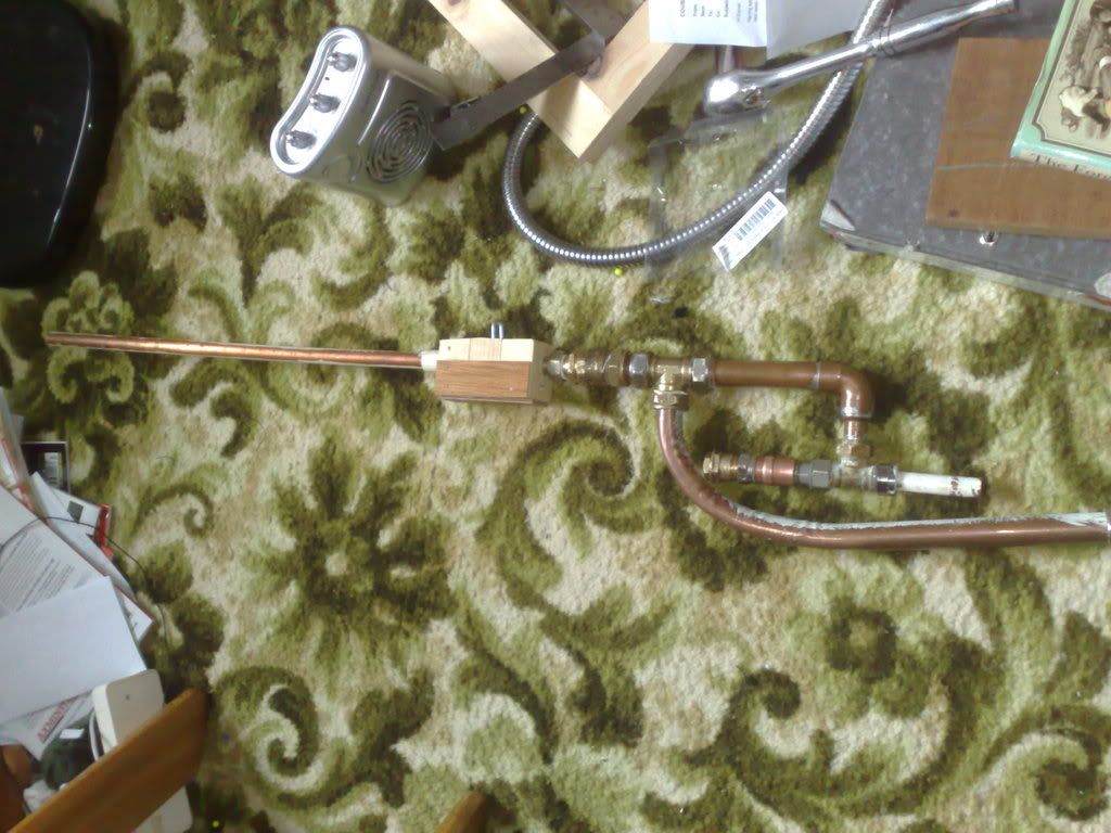

Unread postAuthor: trollhameran » Sun Aug 17, 2008 10:59 am
I would definitely recommend it instead of a blowgun, it is so easy to make and it can be build straight onto the end of your pipe, so you dont need to buy any fixings to get the pipe down to the right size to fix on to the blowgun.
Heres a video and a picture of a gun I just put it onto to test it, its not very powerful....at the moment but i plan to reduce the pilot size massively and increase the chamber size and barrel length.
Also I know the barrel isn't straight, I was playing around with the falling block design again and its just something I threw together out of scrap.
