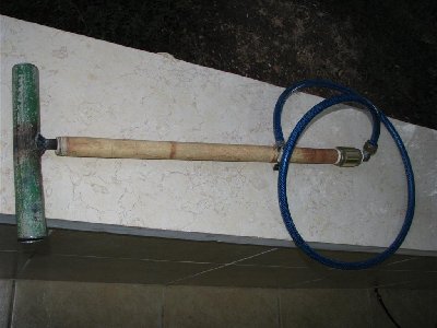

this is my home made air pump
updated

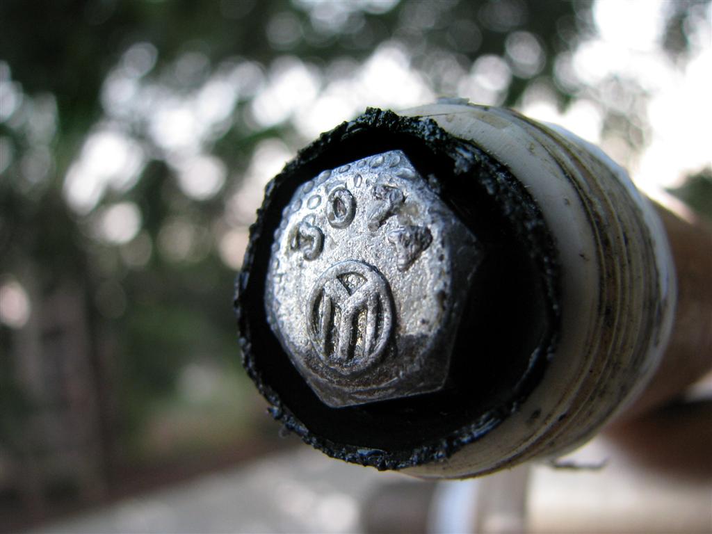

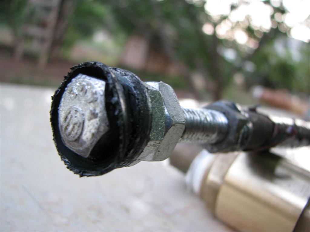

ok in those 2 pictures you can see the piston
the strange thing i don't use any O ring because i don't find one to fit so i cut from track wheel tube a circle a little bit bigger from diameter of the cylinder and drill it in the center

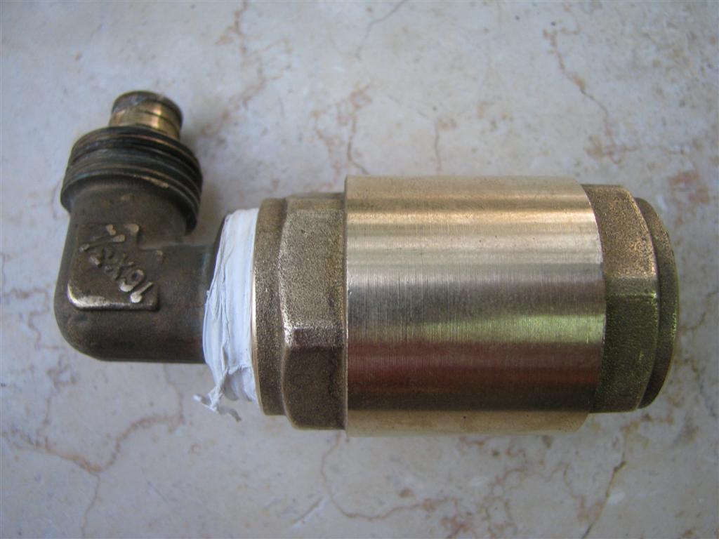

this is the check valve . ok lits say a 3/4in water check valve
this is the pump
this is a cooking gas tube that cant handle pressure

Unread postAuthor: Gippeto » Wed Aug 27, 2008 1:46 pm
I think it is great that you have shown initiative and creativity building your own pump. :)
But;
I am sorry to tell you this. :(
I have serious problems with using plastic as the pump cylinder.
Using your pump generates heat from friction and also from compressing the air.
Heat WILL soften the plastic, possibly causing it to blow out.
You could and likely will be injured if that happens. :cry:
I must in good conscience recommend that you stop using your pump.
If you continue to use it, that is your choice.
  • 0
