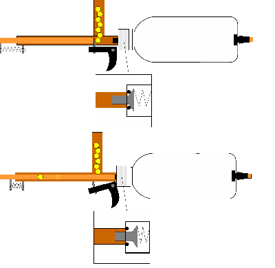

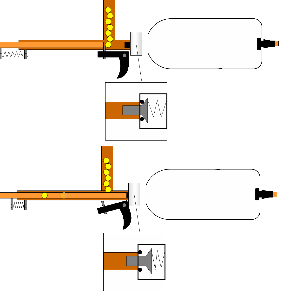

Unread postAuthor: iknowmy3tables » Sun Jan 25, 2009 8:46 pm
no just use soda bottles they are safe to 100psi
EDIT: I would recommend Antonio's old design, I think it was about last summer this design got kinda popular because it allows you to tap off a small bottle air source for multiple shots effectively
