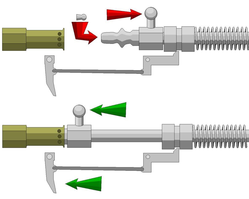

Hey dave ever since our conversation about hammer valves I have actually come up with a design for use with the quick connect method...
It is essentially the CONDOR valve, only the entire barrel moves to cock the weight and slides completely back
It is way overdone, but since getting a severe virus and having to reformat my hard drive and internet was not working, all I had was paint... so I spent it all that time on making this drawing
It is pretty much self explanatory, I think it would work rather well, assuming you could find a way to fit it all in a proper enclosure.

WOAH, I thought that was a commercial diagram. respect
That looks really simple, easy to build and very powerful (Due to the design)

You would probably want to scale it up and use pressure washer QC's.
