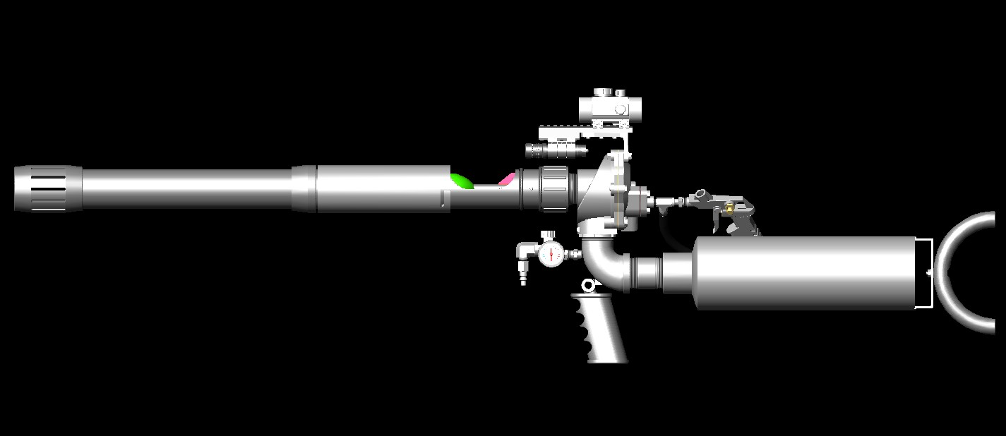

Here is a rendering of my version of a Nerf Pocket Vortex Launcher.
An old version of Autocad was used for both drawing and rendering.
It uses:
(a) 1-1/2" Asco valve (paid about $15 for these valves a year ago)
(b) 5 pound modified fire extinguisher that is approximately 185 cubic inches for the chamber. Typical operating pressure is 40 to 125 psi.
(c) Modified tire inflator for triggering.
The 1/8" M-F-F tee has epoxy blocking the air flow on the F side directly connected to nozzle of inflator. The piloting air is routed through the tee down the hose to the handle. The exhaust of inflator is the angled port where typically a gauge is installed.
(d) 2" by 30" Breech loading barrel.
Some of you may recognize the components in the rendering.
I converted them to Sketchup files. You can compare the difference by this link:
http://sketchup.google.com/3dwarehouse/ ... revstart=0
Actual construction yet to complete is the breech loading barrel.
I may bypass that step and add that later.
JSR will remember a 2D drawing I did over a year ago.
This first rendering was done with TurboCad
Autocad was used for rendering the remaining images.
Comments and constructive criticism welcome.
edited to add clarification.

Unread postAuthor: Lentamentalisk » Wed Mar 25, 2009 3:46 pm
why not turn the chamber around, so that you can cut down the length of the entire cannon by a foot or two? Also, a 1 1/2" valve is total overkill if you aren't trying to get close to the speed of sound. Honestly, I would suggest you save your self $100 or so, and just go for a 3/4" McMaster QEV, but if you have the money, go for it.
I don't really get how your trigger system is supposed to work. It looks like you have the blowgun outlet hooked up to the inlet, which won't do anything what so ever. Correct me if I am wrong.
Other than that, it looks great!

Unread postAuthor: psycix » Wed Mar 25, 2009 3:47 pm
That looks promising!
Great renders too. What program did you use?
What pressure will this thing run at?
Only thing I could complain about is the hose of the blowgun but thats inevitable unless you pilot it with a QEV or something like that.

Unread postAuthor: psycix » Wed Mar 25, 2009 4:23 pm
Because the chamber now also functions as shoulder stock.
  • 0

Unread postAuthor: starman » Wed Mar 25, 2009 5:42 pm
Beautiful rendering! and good looking design as well.
I'm with Lentamentalisk in that for a nerfy, the 1.5" valve is way overkill. However, if you have ideas of making this a brute golf ball gun, I say keep the 1.5" valve... 8) The big valve does give it a tough look.

Unread postAuthor: Fnord » Wed Mar 25, 2009 6:40 pm
When I made my asco golfball gun, I turned the valve 90* from your setup and put an elbow on the barrel. That way there's no valve in your way when aiming, and you can put the trigger on the bottom.

Unread postAuthor: PinHead » Wed Mar 25, 2009 6:45 pm
By the looks of it, is this going to be used for scenario paintball? If that's the case, do you have plans to add a CO2 setup at some point?
I agree that the chamber makes a nice shoulder stock, but for portability, I would suggest perhaps taking down the barrel a little bit. Most of the nerf cannons I have seen don't go over 21 inches of barrel length, and their accuracy and efficiency is just fine.

Unread postAuthor: dewey-1 » Thu Mar 26, 2009 8:52 am
Thanks for the comments and concerns.
Please read the original posting because I added some comments to it to clarify any misunderstandings.
Well as far as valve cost and "overkill" for such an application it was easy to decide when you can buy such a valve for about $15 (USD).
Bought two of them last year on e-bay.
An old version of Autocad was used to create and render the last 3 images. I have been using Autocad for almost 20 years so I am fairly proficient in using it. I still have not tried any complex drawings using sketchup.
I am only using it (sketchup) as a method for others to use my drawings for their personal use without the high price of CAD software.
