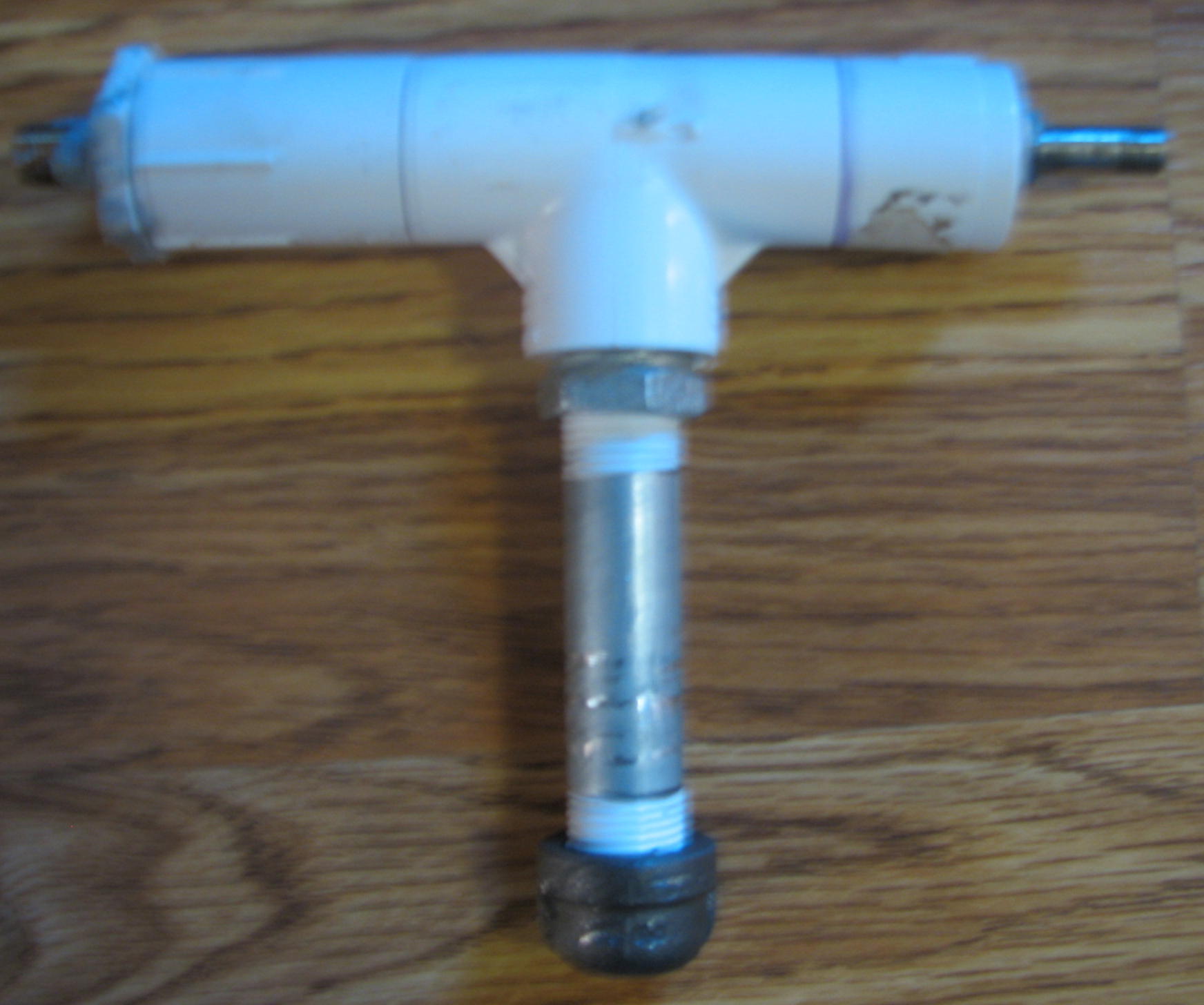

This is my first piston gun, and I decided to start small. The piston is made of hot glue and a bike inner tube for the sealing face. I am currently piloting it with a schrader valve, but eventually I will pilot it with a blowgun. It has 1/8" porting and once a I get a bb barrel will be a bb pistol. My tee and some of my fittings are pvc, and 1/2" pvc pipe is rated to 600 psi. Everyone always says the glued fittings will fail before this pressure. So what is the highest pressure in psi that can be used safely? Also what is the best lubricant to use to make the piston slide smooth? I thank you all in advance for any help.
  • 0
The right part is the shcrader and the left is the 1/8" nipple.

since you say its rated to 600, and since its pvc i would think about 200psi. even if its rated to 600 the glue will start to spring leaks above 200.
if you put epoxy at all the joints you may be able to go to 300psi but not very often.

spudtyrrant wrote:since you say its rated to 600, and since its pvc i would think about 200psi. even if its rated to 600 the glue will start to spring leaks above 200.
A glued joint is stronger than the individual components themselves. If the pipe says it's rated to 600 PSI water, then it will take 600 PSI of water.
Only catch is you're using air, and there is an additional shock factor. Therefore, I would use maybe 200 PSI max for safety.
As for the lubricant, I would just use white lithium grease. Works fine for me and others.

Air doesn't exert more force, but if it were to break, it contains a lot more energy, so unless it says on it 600psi, I wouldn't really take it past 200. Often store assistants will just make things up they don't know to please a customer.

Air doesn't exert more force, but the piston slamming back in the carriage is putting extra stress on fittings designed to hold non-critical fluids in a stationary setting.
1/2" PVC is rated to 600 psi.

So with a sufficient bumper it would be safe at 250?

I wouldn't like pushing my luck that much. I'd feel safer at 200 and below, but it's your decision.
Assuming, of course, that the joint has been correctly bonded and there are no imperfections whatsoever.
I agree with the others also, 200PSI sounds like a nice...round...number. :)

Unread postAuthor: Brian the brain » Sat Apr 04, 2009 5:16 pm
Just always keep safety in mind.
If you feel you need more power, go with metal or upscale the cannon.
There is no sense in pushing your luck when there are more sensible ways of achieving your goals.Moar power means more danger.Never forget that.
A lot of guys use high pressure these days, but 200 psi is still nothing to sneeze at.
You'll have a lot of fun with this one I assure you.Don't let them ( or me)get to you... :D
So..again...once this gets boring, it's time to upscale or use metal.
