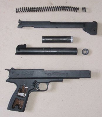

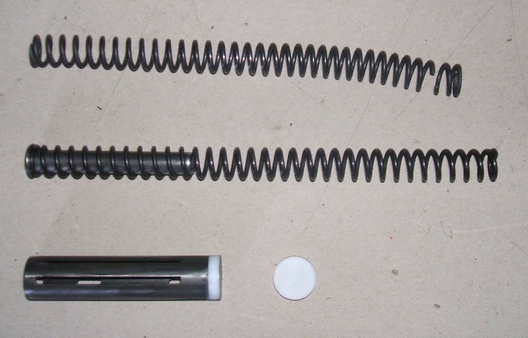

I have one of these, recently I had to change the spring and it was quite a chore. As you can see from the attached pics it's a massive affair and with lots of preload, if fact there's no way you could preload it manually by pulling, let alone cock it - this is why most springers use some sort of lever mechanism.
Even with all this stored energy, it only manages 4.5 ft/lbs of muzzle energy. This is equivalent to chucking a 100 gram slug of potato at a mere 35 feet per second, something which even the most basic combustion will achieve with no effort whatsoever.
