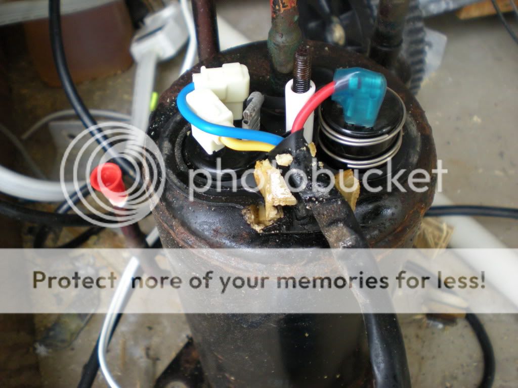

Unread postAuthor: boyntonstu » Thu Jul 30, 2009 4:25 pm
Technician1002 wrote:
boyntonstu wrote:
The capacitor is definitely a run capacitor. Since it was connected with only 2 wires, it seems that the wiring is complete.
BoyntonStu
What's so hard at looking at the side of the compressor under the little cover?
The difference in a run and start capacitor besides the size is the presence or absence of a relay ON THE SIDE of THE COMPRESSOR that disconnects the capacitor after the compressor starts.
It is true there are two leads that connect to POWER. Between the capacitor and motor is 3 leads.
On the leads shown here;
BLUE is the RUN. It connects to both the RUN on the compressor through the coil on the relay if one is present and POWER on the capacitor.
RED is COMMON. It connect to the common terminal of the compressor.
Grab a pic of the connections on the compressor itself. Most often the relay is disguised as a plug that attaches to the terminals of the compressor. If you didn't remove it, it if it exists, is still on the compressor.
Yellow is EITHER START or RUN CAP. To tell, you have to take the cover off the compressor and look for a START RELAY.. What is so hard about looking under the cover? I suspect the yellow wire connects to a terminal on a relay under the cover. Until someone looks there is no way to tell what is under the cover.
Under the hood:
http://i348.photobucket.com/albums/q339 ... top001.jpg
I intend to reuse the empty dryer as a tube air filter.
http://i348.photobucket.com/albums/q339 ... top002.jpg
BoyntonStu

Unread postAuthor: Technician1002 » Thu Jul 30, 2009 4:30 pm
BoyntonStu
Under the hood:
BoyntonStu
Well done. No relay, only a thermal cut out on the common lead. That is indeed a run cap.
EDIT..
If you work in the field an easy way to tell is to grab a clamp around (Amp Clamp) ammeter. A run cap has current when running and a start cap current drops to zero after starting.
  • 0
