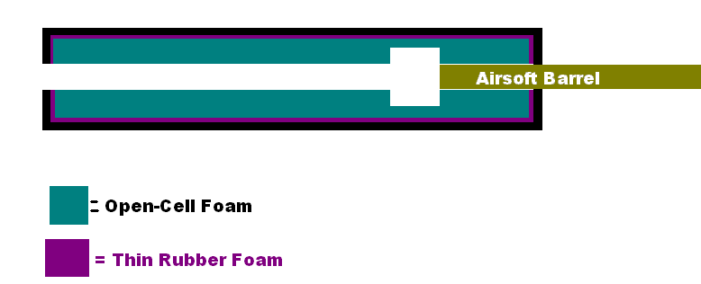

Unread postAuthor: Davidvaini » Thu Sep 17, 2009 1:48 am
its okay, the default search on here sucks.
I think it all depends on what you really want.
For Airsoft Guns, a typical baffle system doesn't really work that well because you are not trying to cool down any gases by letting them expand in a chamber.
Most of the noise comes from the gearbox of the gun, but some does come out the barrel. So I create a suppressor that is designed like this:
and it seems to work out really well. It allows for the noise that does come out the barrel to hit silencing foam and be absorbed.
But for larger cannons with a larger volume of air, I'm sure there is a better way of doing things.
  • 0
