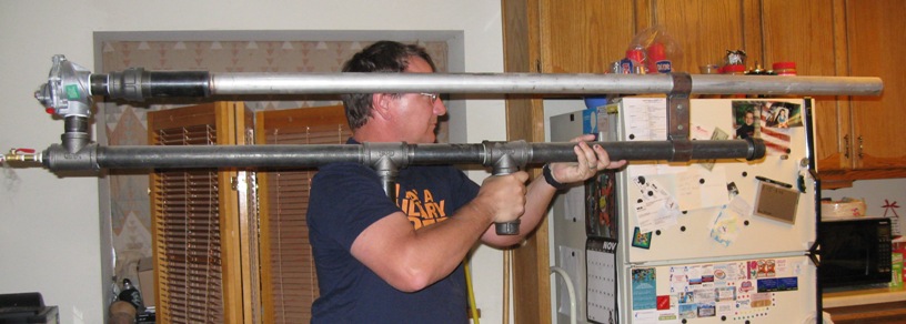

Unread postAuthor: D_Hall » Thu Nov 12, 2009 12:11 am
SEAKING9006 wrote:Too bad accurately mimicking the ergonomics of a traditional rifle are far from simple using standard plumbing parts.... :x
You can come pretty close. Below is a pic I just took of a gun I've got 90% finished (really need to get off my arse and finish it!). Nothing but off the shelf parts there and the ergonomics are very close to a normal rifle.
(And despite being made from steel - not PVC - it's still pretty easy to handle. Why? Because ergonomics were considered from the ground up. It handles pretty much like a normal rifle.)

Unread postAuthor: jackssmirkingrevenge » Thu Nov 12, 2009 12:35 am
D_Hall wrote:Nothing but off the shelf parts there and the ergonomics are very close to a normal rifle.
Well, almost ;)
Looks like it can handle quite a bit of pressure...

Unread postAuthor: iknowmy3tables » Thu Nov 12, 2009 1:16 am
this is how I made a rifle style stock out of pvc
@D_Hall: though the weight seams fairly balanced on your shoulder the barrel placement on that gun looks pretty high so the lack of muzzle weight and high barrel placement looks like you'll have a good bit of muzzle jump on that gun

Unread postAuthor: jackssmirkingrevenge » Thu Nov 12, 2009 1:20 am
iknowmy3tables wrote:though the weight seams fairly balanced on your shoulder the barrel placement on that gun looks pretty high so the lack of muzzle weight and high barrel placement looks like you'll have a good bit of muzzle jump on that gun
The man has a point, perhaps it ought to be inverted so the barrel is resting on your shoulder?

Unread postAuthor: D_Hall » Thu Nov 12, 2009 1:31 am
Three words: moment of inertia.
Not to say that there won't be muzzle jump. Rather, to say that I think it will be managable due to the moment of inertia that a long, heavy gun results in.
