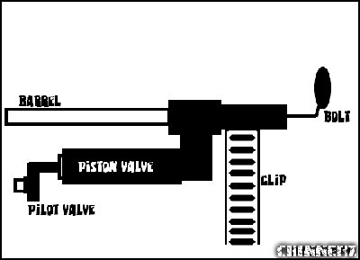

ok this is my idea for my bolt system
can you point out some flaws and how i can fix them btw i want it to stay as much like this as possible . I want a bolt action that resembles AWP ,L96, Arctic Warfare or whatever its real name is .... lol

Unread postAuthor: rp181 » Sat Jan 09, 2010 12:03 am
looks fine, the bolt needs to lock though, don't want it shooting out.
It does limit your projectile length though.

Unread postAuthor: Major Collins » Sat Jan 09, 2010 12:17 am
yes i forgot to add that in the pic it was just going to be extended piece of barrel coming out of the back tee and a line cut into it for the bolt to lock into ummm i was going just for shooting .22 pellets would this be alright?
an why does it limit the length ?
and if i made the hole bigger it would increase airflow but the pellet would fall in the hole (... if you understand?) how could i prevent this and maximize airflow?

Unread postAuthor: john bunsenburner » Sat Jan 09, 2010 4:31 am
You could either cut several holes or one long one, just make sure what ever you cut is smaller than your ammo!

Unread postAuthor: chinnerz » Sat Jan 09, 2010 6:06 am
Wow that’s a super idea!! Just a quick question, if the air has to make a 90* turn will that decrease its speed? Or in any way lower the final velocity of the round?

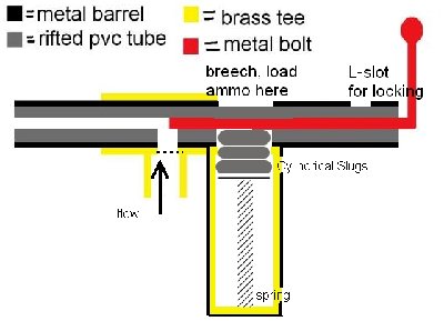

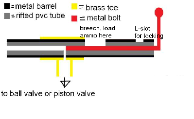

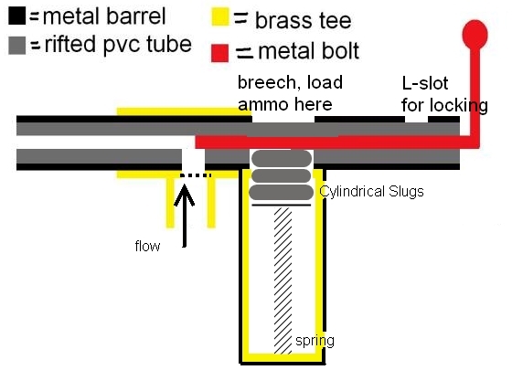

Unread postAuthor: psycix » Sat Jan 09, 2010 7:46 am
A suggestion.
EDIT:
There is an error in the design... In this state the bolt handle should be in the L-slot. So the bolt length is wrong.
I'm not feeling like editing the pic so just take note.

Unread postAuthor: chinnerz » Sat Jan 09, 2010 8:01 am
just had an idea (duck for cover), you could make a clip at the back so it is a bit more like a "shell-les" bolt action rifle.
also i agree with it needing a bolt lock, because chances are that it will blow out

Unread postAuthor: john bunsenburner » Sat Jan 09, 2010 8:10 am
The danger with that is that, when using pellets, like previously stated, there is a chance the spring pushes not one, but two projectiles into the barrel. Also, in most cases you need to re-fill the gun anyway, reloading ammo is the least of your worries...
When using slugs and a direct connection to a compressor or large tank then this is a valid option.

Unread postAuthor: Brian the brain » Sat Jan 09, 2010 10:32 am
Wait...are you trying to make your version of my " Old Shatterhand"??
Seems it has everything you need..exept the mag feed from the bottom.
It has the same Tee-bolt and I can assure you, it is very powerfull despite the 90 turn and slightly smaller port to the barrel.
Cilindrical ammo will not double feed when fed from the bottom up to the back of the Tee...
In fact, it is a sure way of preventing it.
