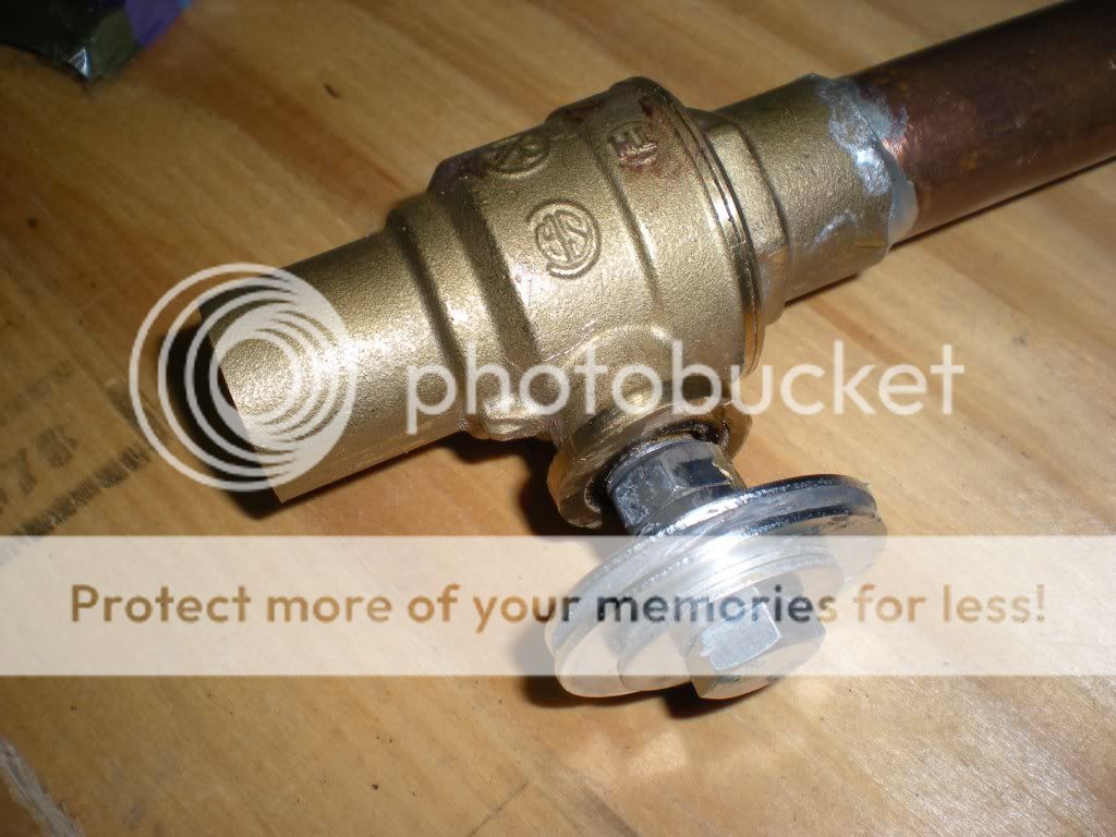

I removed the brass stop and the ball is able to freely rotate.
I made a coupler nut by brazing 2 M8-1.25 nuts together.
The "pulley" consists of 3 fender washers epoxied together with JB Weld.
The inner fender washer is slightly smaller in diameter.
The 1/4 pulley circumference is slightly over 1".
If my 50 pound crossbow can pull a string wrapped around the pulley at about 100 fps, the ball valve will open in 0.001 second.
That is my goal.

How many revolutions does it have to turn to get up to that speed?
Seriously, what is the effective mass of the moving parts and what is the accelerating force? From there acceleration can be found and time to move 1 inch from a dead stop can be found. 1 ms sounds optimistic, but it may be possible. With the brass body and induced currents (shielding) the magnet in the valve method of measurement wont work with the magnet inside the valve. A magnet on the pulley with a pair of pickup coils is an alternative location. I would be interested in your measured and calculated opening time.

Technician1002 wrote:How many revolutions does it have to turn to get up to that speed?
With a Casio EX FS-10 camera at 1000 fps I should be able to directly view and measure the ball opening time.

Unread postAuthor: Technician1002 » Wed May 19, 2010 11:22 pm
Only $130? I thought they were considerably more expensive. I just assumed they were over $600. I'll have to keep my eyes open for one. It would, at twice the price of a shooting chrony, be much more useful.
Just a quick note, if the valve indeed did open in 1MS, that camera is too slow. It would fully open from one frame to the next. The frames are 1ms apart at the fastest 1,000 frames/sec speed of the camera.
Somehow I doubt the valve can be that quick.

i think if you give the crossbow your using some weight(just on the string like fishing sinkers) and leave room for it to accelerate then for it to yank the valve open it would be quicker

Unread postAuthor: boyntonstu » Thu May 20, 2010 5:37 am
Technician1002 wrote:Only $130? I thought they were considerably more expensive. I just assumed they were over $600. I'll have to keep my eyes open for one. It would, at twice the price of a shooting chrony, be much more useful.
I have my doubts too, however the goal and the project to attempt it is interesting.
If it can open fast enough to equal a piston valve, it would be a great performer because the chamber to the barrel is a straight 3/4" through the ball.
I have not measured the ball opening ID but I am sure that it opens wider than the seat of a piston valve. No bends, and minimum turbulence adds to its potential performance.
If people say that it can't be done, I usually take the bait.
That's how my $100 trustworthy elevator got built 7 years ago.
http://www.youtube.com/watch?v=_hom61NxuaE
Besides, it gives me an excuse to buy a high speed camera.

"i think if you give the crossbow your using some weight(just on the string like fishing sinkers) and leave room for it to accelerate then for it to yank the valve open it would be quicker"
That is worth a try.
