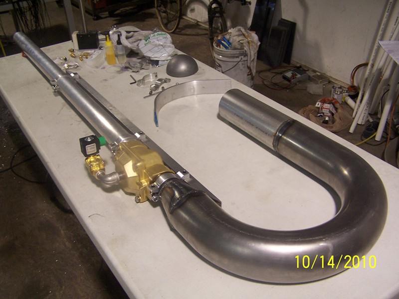

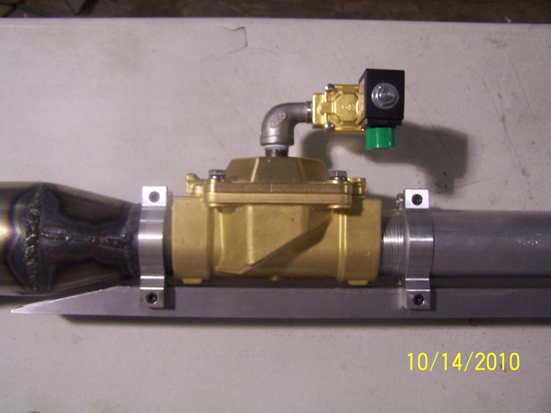

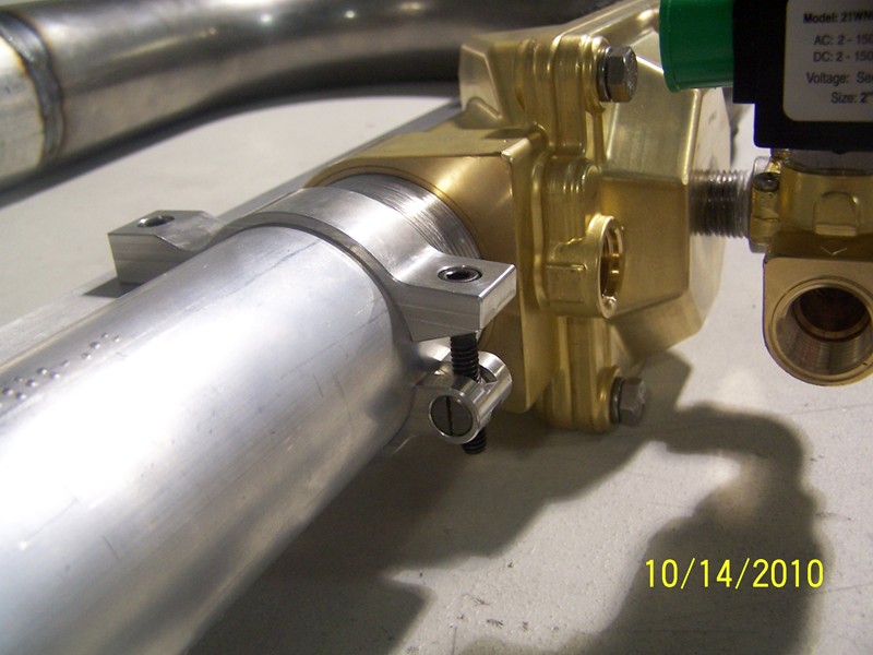

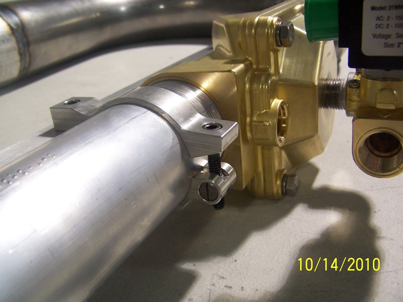

Unread postAuthor: High-PSI » Thu Oct 14, 2010 5:57 pm
Here are some pictures of the progress so far.
I installed the pilot valve and began the frame spar. The spar will hold the two grips and shoulder stock. The pinch clamps we made at the shop on the big CNC. :)
I will post more pictures as I have them.
Matt

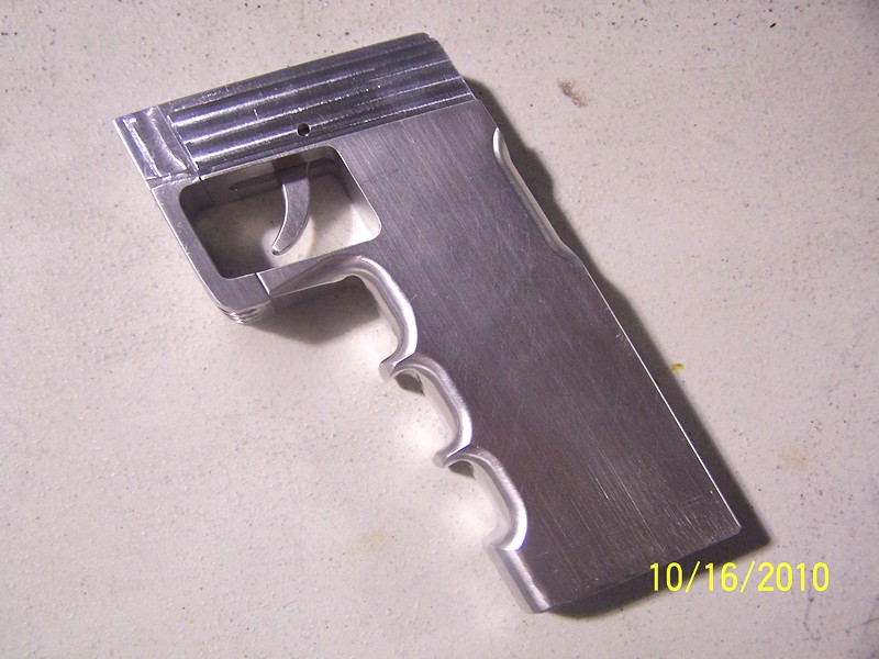

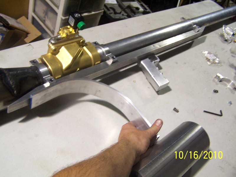

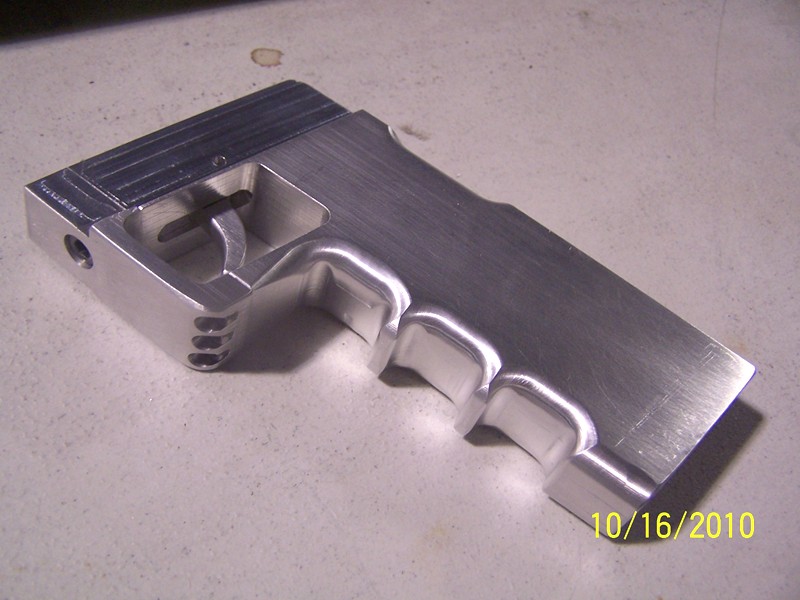

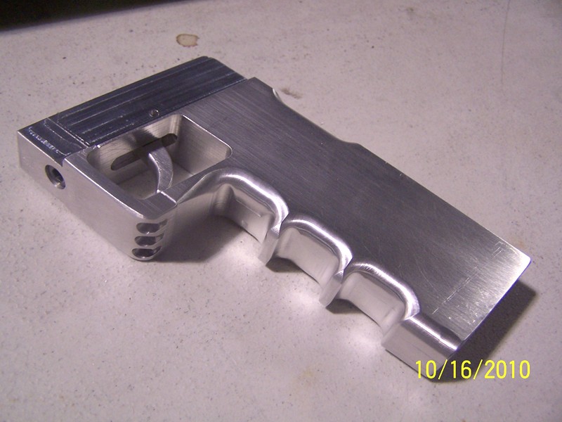

Unread postAuthor: High-PSI » Sat Oct 16, 2010 11:51 am
Here are a few pictures of the grip. I have about 5 hours of time spent machining this from a block of 1 inch 6061.
You can see its orientation on the gun along with a very rough version of the shoulder rest/stock. Both parts are just resting there. Neither is installed. I am just holding the shoulder rest in place to give an idea of the layout of the gun. That rest will be very solidly braced and padded with 1/2 inch thick Neoprene.
Matt

Unread postAuthor: jackssmirkingrevenge » Sat Oct 16, 2010 12:28 pm
Impressive, how long before you have it ready for firing tests?
  • 0
Donating Member
Donating Member
Posts: 24964
Reputation: 118
Unread postAuthor: Technician1002 » Sat Oct 16, 2010 12:32 pm
I really like this. The trigger guard is a nice touch. I'm impressed.
May I come and play in your shop?
  • 0
