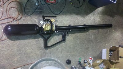

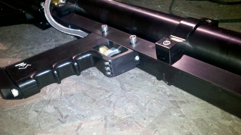

Unread postAuthor: High-PSI » Sat Jan 21, 2012 1:06 pm
I figured I would update my thread with some detailed information and pictures of the cannon at this point.
The tank and shoulder stock are steel. They were powder coated black. The barrel, machined barrel clamps, grip, and rail are aluminum. I had them anodized black. I updated the pilot tube from the original copper item to a braided stainless tube for looks and durability.
Also, I hydro tested the tank to 625 psi. So, I know it is safe. I will be firing the cannon at 400 psi this year (possibly up to 500 psi if my should can take the kick). GGDT shows 3,000 ft pounds of power at 500 psi. So, I am not sure I want to hang onto it at that pressure!
Anyway, my compressor is taking up much of my time now. But, I wanted to show you guys the pictures and give an update on this while I had a few minutes. :)

Unread postAuthor: Gun Freak » Sat Jan 21, 2012 1:19 pm
:notworthy: :hello1:
  • 0
Gun Freak
Lieutenant General
Lieutenant General
Posts: 4976
Country: United States (us)
Reputation: 14
Unread postAuthor: Brian the brain » Sat Jan 21, 2012 2:24 pm
Beautiful!!
I had missed this earlier due to a break from spudding but wow!
I have a similar sized valve on my large 3" barreled cannon.
Maybe I should go with a smaller diameter bore..
Looks absolutely great!
