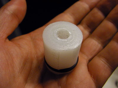

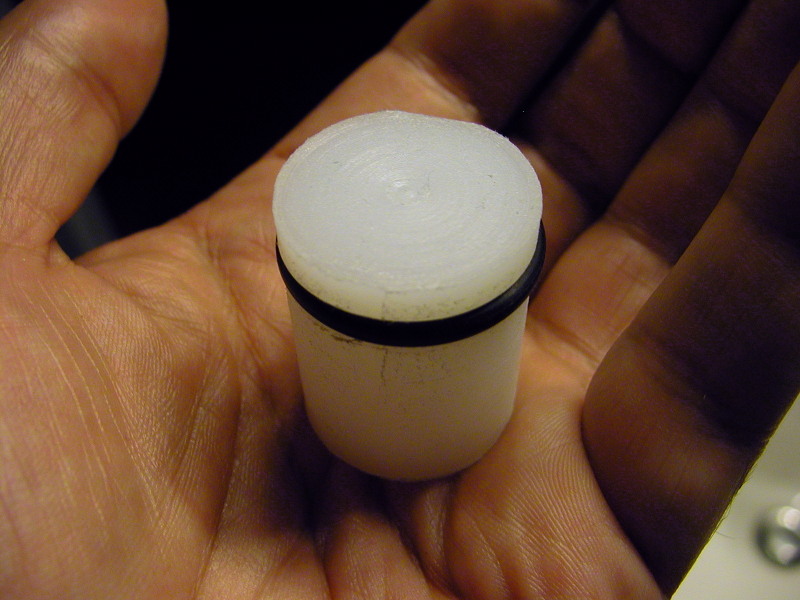

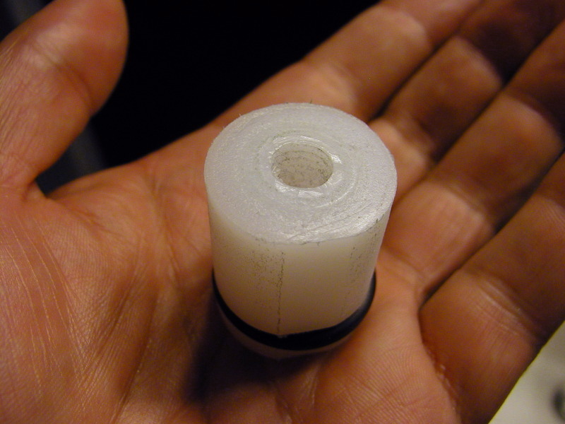

Unread postAuthor: Technician1002 » Fri Oct 15, 2010 5:24 pm
There is no reason to make a hole all the way through a piston when it is made on a drill press. The prevents it from leaking through the bolt hole.
  • 0
Pilot side has no hole to leak.
Piston face has a place to screw on a rubber washer.

Unread postAuthor: Benjg555 » Fri Oct 15, 2010 5:39 pm
Ohh alright I see now :D
And that gut with the o ring should be able to smoothly slide up down the release for air were it will be moving right? And the rubber washer acts like a bumper. Just wanna make sure before I get into building it.
Also I'm going to draw a 3/4 circle from template then cut with a bandsaw so it is round instead of rigid because the drill press moves fast. Length 1inch?

Unread postAuthor: Technician1002 » Fri Oct 15, 2010 8:27 pm
OK.. The rubber on the face of the piston is to keep air from leaking into the barrel before it is fired. The bumper goes in the pilot so the piston doesn't crash out the back when it is fired. One is a pad, one is a seal against leaking. The o ring reduces the leaking from the chamber into the pilot area for a barrel sealer piston valve. I hope that helps.
If the piston is 1/2 inch in diameter and the barrel is 1/2 inch in diameter, the piston may blow out the barrel as it can fit inside. :roll:
The Wiki on Piston valves is a good resource too. The only piston where the piston and the barrel is the same size is the QDV valve which does not use pilot pressure to move the valve.
