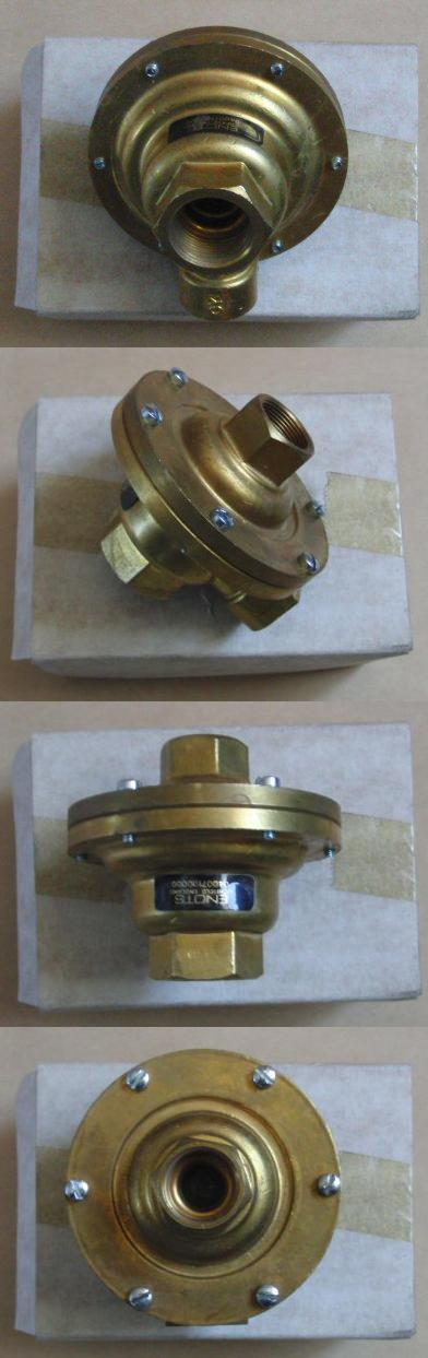

I just ordered this -
Unread postAuthor: Slugfoot » Sat Jan 08, 2011 1:46 am
- http://cgi.ebay.co.uk/ws/eBayISAPI.dll? ... SA:GB:1123
1/2" old-skool qev. :D
There are still a couple left if anybody here is interested.
The brass finish and the shape attracted me.
I'm guessing it uses a diaphragm like a rainbird valve or something. What sort of pressures would you trust it at?
Has anyone here used anything similar before?...What was it like?
I'm curious...

Unread postAuthor: jackssmirkingrevenge » Sat Jan 08, 2011 1:58 am
Good find! I just enquired about postage to epoxyland :)
The construction does suggest it uses a diaphragm.

Unread postAuthor: Slugfoot » Sat Jan 08, 2011 2:05 am
Just noticed this -
"This item requires Enots nuts and sleeves for all three ports on this valve. "
Is anyone here familiar with Enots threads etc.? I've never heard of them before. I'm just hoping I'll be able to buy BSP/metric adapters for it. :confused1:

Unread postAuthor: POLAND_SPUD » Sat Jan 08, 2011 5:27 am
I just ordered this
Ordering FAIL!!
lol don't worry we've all been there :oops:
Naah wait... I did a quick google search and it seems that enot nuts and sleeves are just compression fittings
http://www.airlink-compressors.co.uk/pr ... t-imperial
So I guess it has standard 1/2" BSP threads

Unread postAuthor: spudamine » Sat Jan 08, 2011 7:01 am
guess fail :lol:
yes they're industrial copmpession fittings, unlike normal compression fittings the compression nut has a male thread. the 1/2" refers to the OD of the pipe to be used, here's a datasheet:
http://docs-europe.electrocomponents.com/webdocs/0026/0900766b80026e10.pdf
look on page 6, the thread for a 1/2" fitting is 3/4 x 24TPI Which is a lot finer than a bsp thread.
still i'm sure you can bodge somerthing together with brute force and plenty of epoxy :D

Unread postAuthor: jackssmirkingrevenge » Sun Jan 16, 2011 12:03 am
Update: arrived this morning, yes it's a diaphragm valve and yes the threads are bigger than 1/2" BSP, almost big enough to fit 3/4" BSP.
No problem for yours truly and his binary adhesive stockpile of course, will have a play after Monday when the other half finally heads back to the motherland :roll:
I'm thinking of using one of these as a pilot to make a small calibre semi-auto...
