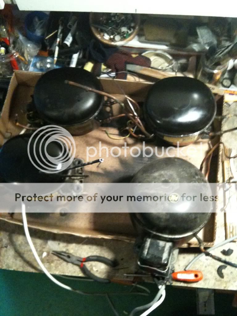

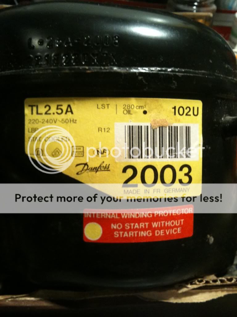

Hi i just got my hands on a fridge compressor and i cant get to run.
I have connected:
blue to the upper N
brown to L
and yellow/green to ground
What is the problem? Is the wires connected wrong or is the compressor broken?
It is a Danfoss Tl2.5A
<a href="http://s928.photobucket.com/albums/ad126/pipeboyswe/?action=view&amp;current=IMG_0061.jpg" target="_blank"><img src="http://i928.photobucket.com/albums/ad126/pipeboyswe/IMG_0061.jpg" border="0" alt="Photobucket"></a>
<a href="http://s928.photobucket.com/albums/ad126/pipeboyswe/?action=view&amp;current=IMG_0062.jpg" target="_blank"><img src="http://i928.photobucket.com/albums/ad126/pipeboyswe/IMG_0062.jpg" border="0" alt="Photobucket"></a>
<a href="http://s928.photobucket.com/albums/ad126/pipeboyswe/?action=view&amp;current=IMG_0064.jpg" target="_blank"><img src="http://i928.photobucket.com/albums/ad126/pipeboyswe/IMG_0064.jpg" border="0" alt="Photobucket"></a>

Iv got two compressors hooked up the same way but i cant hear a klick or anything none of them will run :(

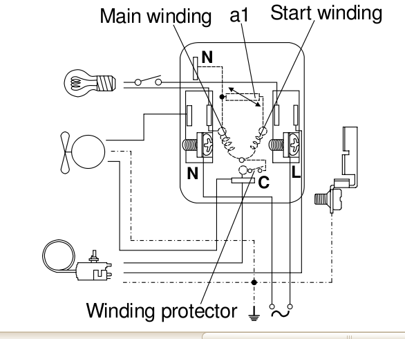

You need a wire from the C terminal to L terminal.
This will simulate the thermostat switch.
This link will show a wiring diagram.
http://www.ra.danfoss.com/TechnicalInfo ... 42s402.pdf

Do you have a capacitor from an air conditioning unit? Read the red label, "No start without starting device". Usually means you need a capacitor, or the thermostat.

Some compressors only use the starting relay. As mentioned above, an external capacitor may be required. That is an old compressor. It used R12 which has been banned in most of the world for more than a decade.

Unread postAuthor: pipeboyswe » Thu May 26, 2011 11:58 am
Thanks dewey-1!!! Now it works!!! HP here i come :D now i got 3compressors working :D

The wiring diagram was definitely needed. The connection between the L and C terminals was needed to bypass the thermostat.
