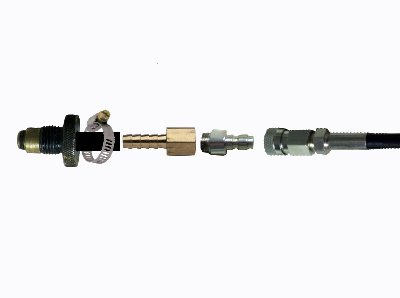

Unread postAuthor: Dornep » Mon Nov 28, 2011 4:49 pm
Not sure how much pressure that hose will be exposed to but if your trying to do what I think your trying to do...
I would get a 1/4" female hose barb and thread out the quick connect fitting out of the "New Remote" and thread it into the hose barb female end and then hose clamp the barb inside your new hose?
  • 0
