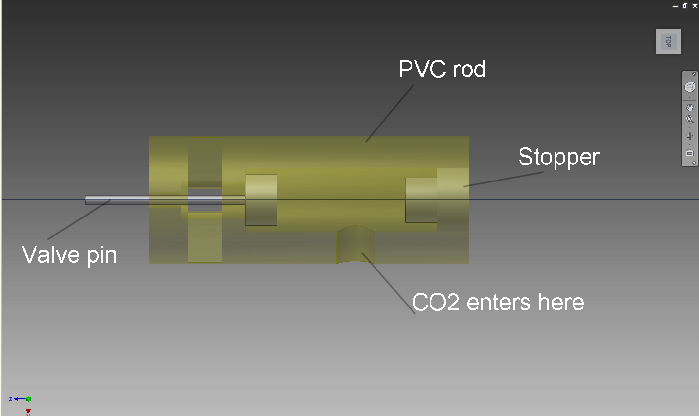

Hi,
I'm glad to become a part of this forum. Seem's like there's more than enough very usefull information here, so that's great. Anyway, to my question. Lately I've been thinking of making a gun, probably with airsoft ammo, but with a valve from a paintball marker. Now I'm not sure of the specific type that uses this valve, but it's pretty much a copy of the one from the paintball gun, just a bit simplified. Now, I have no problems with making it , just with the material to use. I thought I could use a PVC rod and just drill the holes i need into it, but I'm not sure if it could hold the pressure. I would probably use those small 12 gram CO2 cartridges, because I think it's the easiest to get, maybe I'm wrong. So yeah, do you think that the PVC rod could hold the pressure? And what else could I use instead the CO2 cartidges? I'm attaching a picture of the valve and the approximate dimensions. Thanks (The vlave is really easy, a hammer powered by a spring hit's the valve pin and moves it backwards so that air passes by. A little ammount goes back through the hole by the pin and reloads the hammer back into place. Most of the air however traveles through the bigger hole that is cut out and goes towards the other side of the valve through grooves cut out right on the valve and that air shoots the ammo)

Unread postAuthor: Goats spudz » Mon Apr 23, 2012 4:09 pm
Pvc is too soft for 850 PSI of co2 and as co2 cools rapidly when released to the atmosphere the pvc will become brittle and shatter, you would be better with nylon or acetal and a stainless steel valve stem, just search pcp valve or hammer valve, an example is the valve i used on my gun in the thread "machined pcp" its all brass/steel construction and has a nylon sealing face, have fun :D

Unread postAuthor: beastmode986 » Tue Apr 24, 2012 3:21 pm
same design in the tippman 98 custom. extremely helpful diagram. However im not 100% sure how air is released from the front

Unread postAuthor: jan019 » Wed Apr 25, 2012 4:26 pm
Hi,
thanks for the replies. The problem with using other materials is that they're not sold in the shape i need them to be. I have no access to a lathe nor anything similar so the PVC was ideal because it's sold in cylinders and all I'd have to do is drill some holes and that would be all.
How much PSI do you think the PVC could hold? And when you say I could use a paintball tank, how would I refill it and also what kind of valve connection would there have to be?

Unread postAuthor: Goats spudz » Wed Apr 25, 2012 4:35 pm
well you would have to regulate the co2 to 300 psi
