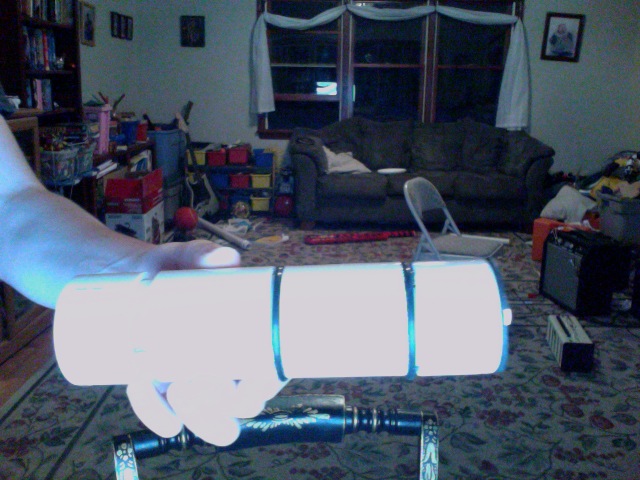

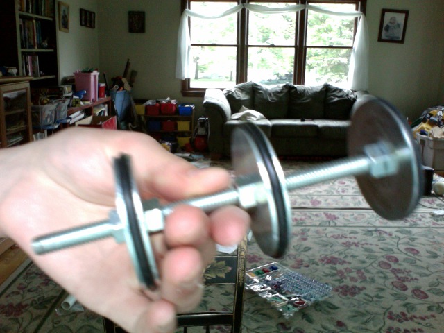

Its based off of techwizzy's A.K.A Gun freaks.
This is the design I'm going to use. It is 2x.1 1/4 inch pvc end caps. 1x. 5 1/6 inch threaded rod. 1x. Neoprene washer. 2x. 1 1/4 inch Pvc couplings. 2x.o-rings. And assortment of nuts and washers. (sorry for bad glare)

Unread postAuthor: jsefcik » Wed May 16, 2012 3:05 pm
Yes that looks fine
But add more rubber on the end that seals on the barrel
And put something to make it airtight around the nuts

Unread postAuthor: Gun Freak » Wed May 16, 2012 3:57 pm
Oooh, nice :)
But, Y U NO use stop nuts?
You may find that you need another rubber washer on the face to account for imperfections in the seat, but try it out first. Looks fine, but that doesn't mean anything ;)

Unread postAuthor: 8tonsemi » Wed May 16, 2012 4:21 pm
The rod actually got cross threaded so I have to rebuild it.
  • 0

Unread postAuthor: mattyzip77 » Wed May 16, 2012 7:50 pm
Once you get that bad boy up and running, make sure you constantly check your bumper. I have had this piston smash through the back female adapter and bushing and a few other members as well. Just be careful. A 2 inch rubber sanding drum works well as a piston in this housing as well and its totally adjustable. Good luck.

Unread postAuthor: Mimikool » Thu May 17, 2012 7:09 am
I don't now what what will you use it for, but the threaded rob looks too thin compared the seat diameter.
I guess this piston will recoil, end shock in the tee or i don't now.
I made a qdv with a 6mm threaded rod and 16mm seat diameter, after some shoots, the rob is completely twisted, and steel washers too.
You piston looks good for the sealing but not very strong.
Sorry if i don't undertsand the problem ^^

Unread postAuthor: mattyzip77 » Thu May 17, 2012 8:43 am
Nahhh, I disagree with above,^^^ as long ad you have a good bumper you will be fine, I use a tennis ball in mine and its The design Gun Freak uses.

Unread postAuthor: Mimikool » Thu May 17, 2012 12:32 pm
Yes, with a good bumper, but after many shoots.. i don't know...
The diameter is large, so the forces are very "strong", with a pneumatical bumper you will certainly no have problem, but there aren't many materials wich could be a good bumper durably.
But if you have experience with that, he would prefer follow you ;) just aninformative theory ^^

Unread postAuthor: Gun Freak » Thu May 17, 2012 9:44 pm
Mine have been through hundreds of shots and the only thing that happens is the washer slightly warp. But the rod doesn't bend :)
