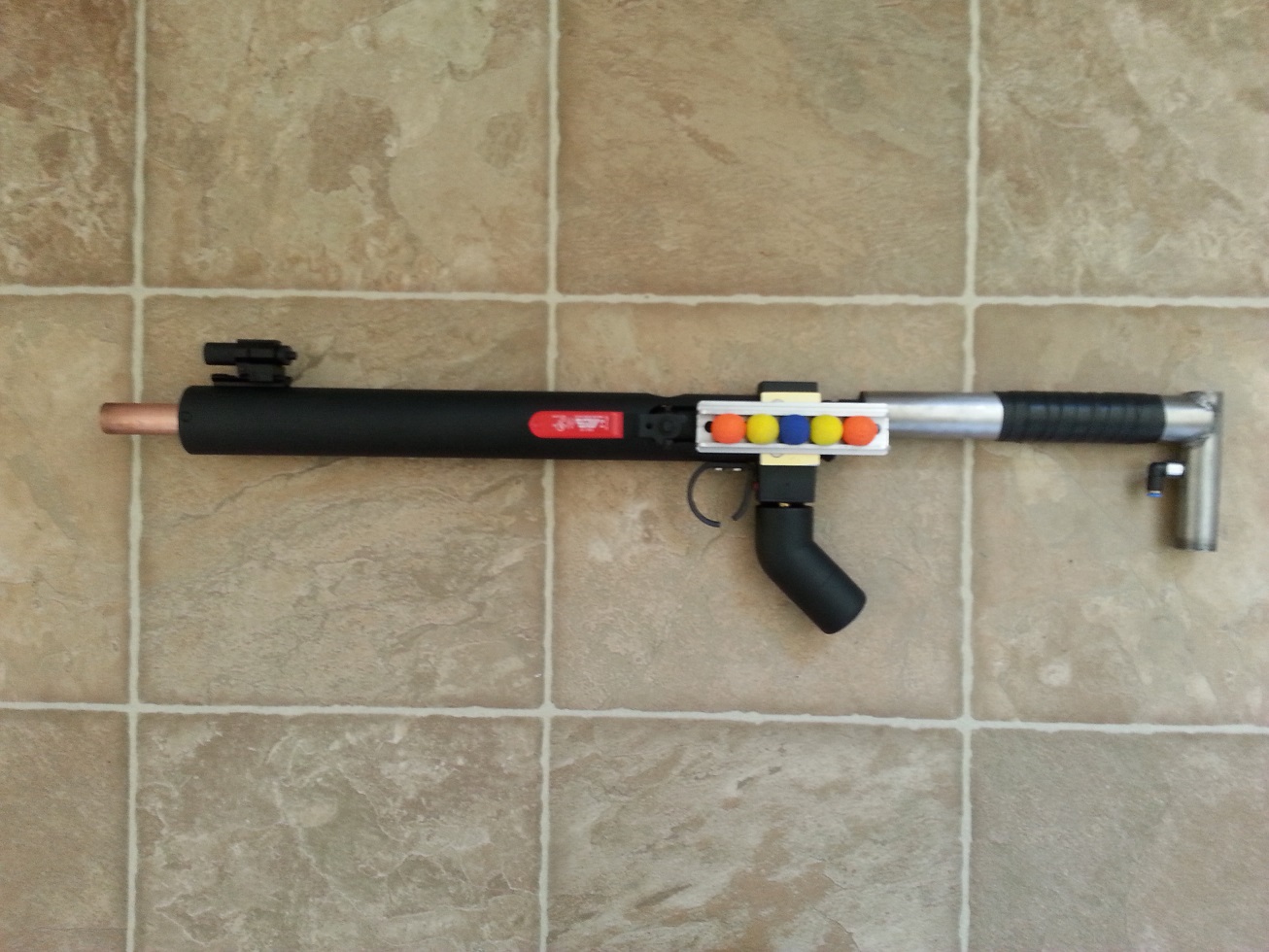

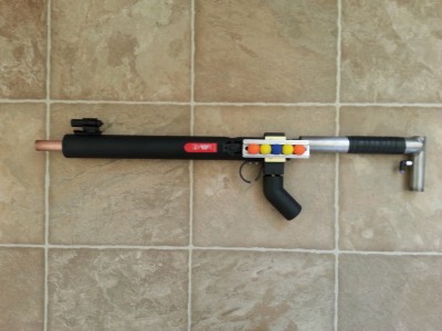

Unread postAuthor: farcticox1 » Sun Jul 29, 2018 8:39 am
This will send Nerf Rival 200ft at 160psi, 3/8 manual trigger air valve, very simple :D

Unread postAuthor: jbmoyer » Sun Jul 29, 2018 8:58 am
farcticox1 wrote:This will send Nerf Rival 200ft at 160psi, 3/8 manual trigger air valve, very simple :D
Very nice, you hook a 3k hpa tank to that? How does it only release a measured amount of air to launch the projectile?

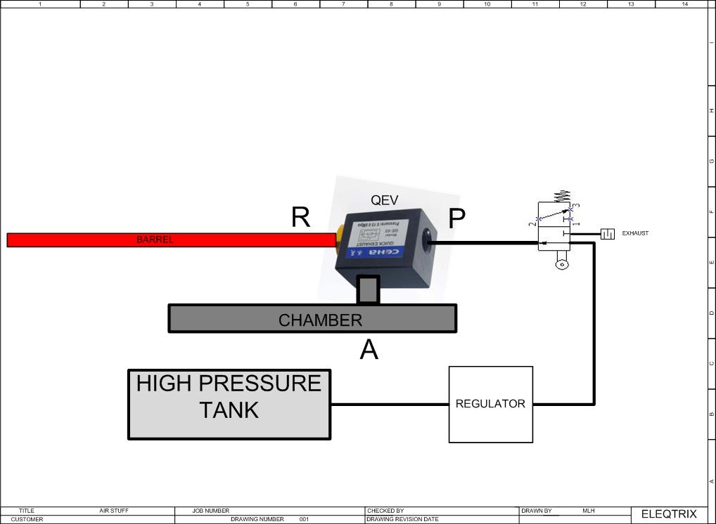

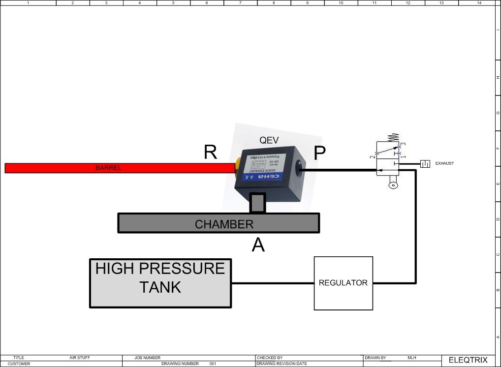

Unread postAuthor: jackssmirkingrevenge » Sun Jul 29, 2018 10:07 am
You might want to consider a quick exhaust valve as opposed to a sprinkler valve.
You connect that to a three way two position valve.
This is the operating principle:
You basically have your air supply along with a secondary chamber. When at rest, the three-way valve allows air from your bottle to fill the secondary chamber ( B to A ). When the three-way valve is actuate, the air supply is shut off and the quick exhaust valve pilot area is exhausted to the atmosphere ( A to C ). This empties the firing chamber to launch the projectile, as soon as the trigger is released the air supply is reconnected and the secondary chamber is refilled, ready for another shot.

Unread postAuthor: jbmoyer » Sun Jul 29, 2018 11:33 am
Ok I've seen some things about QEV, will look further. What Im still confused about is the connection of the 3k HPA tank. That is essentially a constant flow of air. Can the sprinkler valve or QEV manage that? Assume each pull they only let X amount of air through then close? How much air is let out? Need to understand that dynamic before I strap one next to my head. Appreciate all the tips, great information.

Unread postAuthor: farcticox1 » Sun Jul 29, 2018 5:46 pm
With a QEV connected like this it will only dump the low pressure chamber, the high pressure is isolated until after firing for recharging.
QEV from Ebay https://www.ebay.ca/itm/Black-Aluminum- ... 0005.m1851 or Jacks
3/2 trigger valve from Ebay, must have 3 accessible ports as you need normally open, or get a normally open with only 2 accessible ports (if that makes sense) https://www.ebay.ca/itm/Air-Pneumatic-2 ... =R40&rt=nc or Jacks

Unread postAuthor: jbmoyer » Wed Aug 01, 2018 1:18 pm
Ok, great. The idea im trying to build is a HPA powered Nerf Rocket launcher. Load a rocket, "pull" trigger releasing the air through the QEV launching the rocket. Then simply load another rocket and repeat. No need to "charge" the system because the HPA tank is a constant flow only restricted by the QEV.
So the one you linked does that? How is it different from the other QEV? As i understand the QEV prevents airflow until you exhaust and reseats when you release the release valve. Is that correct?

Unread postAuthor: jackssmirkingrevenge » Wed Aug 01, 2018 5:51 pm
The valve I linked to would be used as a trigger for the QEV.
That is correct. By using a three way valve as a release valve, you not only exhaust the QEV but also shut off the main air supply, so no air is wasted and you get a consistent burst of power.
