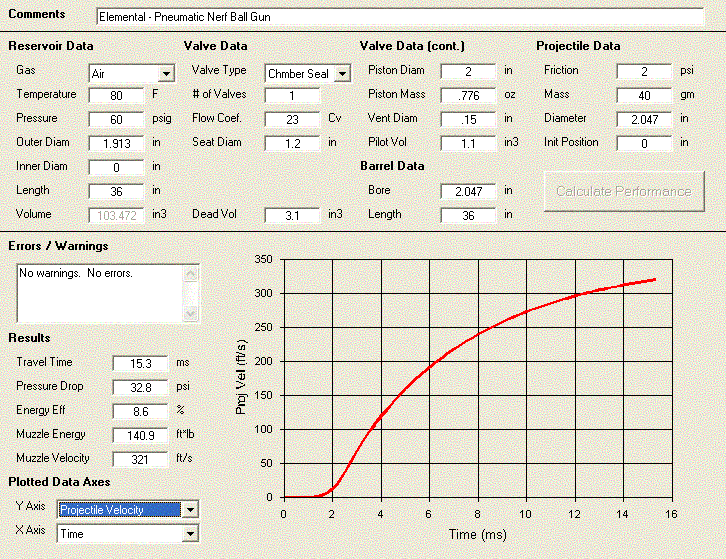

Okay, I'm designing a LAW for paintball that shoots min Nerf vortex footballs (thay are 2" in diameter).
Here's my design so far...
I want it to shoot around 230 fps. I plan on making the air chamber out of 2" diameter Schedule 40 PVC. I want the gun to operate around 30-60 psi.
How long should I make the air chamber for this too work?

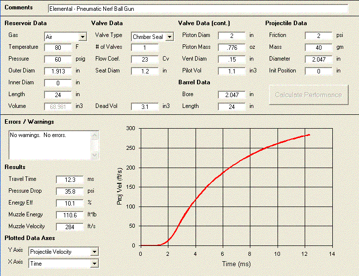

Unread postAuthor: CS » Sun Dec 24, 2006 4:59 am
"Use pressure rated pvc fittings (sch-40), not dwv or abs fittings." ~Benstern
Benstern, while your at it why don't you tell him to wipe his ass after he takes a sh*t? Talk about the basics...
As others have stated, it appears that possibly you intended to use bell reducers. Instead use a reducing bushing, as these allow longer socket depths on connections. I must note that for this issue in particular with bell reducer versus, bushing, wall thickness is not the issue, rather the shorter socket depths. Just thought Id point out as that is often times confused.
Just because everyone else seems to be taking the day off in the answering of your question, I decided to be so nice as to enter the data into GGDT! [If you are not aware of such software, Google the name "GGDT"]
Well I entered the given data into the program, the continued to screen shot the results. Listed are the two variation I tryed.
<a href="http://www.spudfiles.com/uploader/uploadFiles/Elemental.GIF ">3' Chamber/ Barrel @ 60PSI</a>
<a href="http://www.spudfiles.com/uploader/uploadFiles/Elemental1.GIF ">2' Chamber/ Barrel @ 60PSI</a>
Note: I very well could have botched any chance of accurate results with my horrible guesstimation on the projectile info.

Unread postAuthor: CS » Sun Dec 24, 2006 3:13 pm
"How does an inline valve let you use the 3" chamber?" ~Noname
Easy, a 3x2, and a 2x1 bushing.
"Use a 2" chamber, you won't have velocities able to hurt someone, and it'll be more compact." ~Noname
Well I'm not going to support the difference between a 2", and 3" chamber will result in injury, although I would support the claim that it would increase the chance. I also don't think a 2", to 3" chamber will effect how 'compact' the given launcher. Such a addition is going to add ~1" to the height, and ~2" to the width, while leaving the length the same. Length being the issue.
As Noname said, quite possibly in FrankRede's design the threads 'snapped' from the shear stand out weight created by both chamber and barrel. Fastening the chamber and barrel together would eliminate such stress. I suppose that there is a advantage to over-under designs, that one can fasten the two together and eliminate stand out stress put on small diameter joints.
The reason I did not suggest a 3" chamber is that the 2" x 2' version surpassed your request by a estimated 50 FPS, with the 2" x 3' version by ~90FPS. Personally I see no reason for the larger diameter chamber. As you suspected, yes I would believe while increasing the chamber volume that such would result in greater velocities.
I suggest if you'd like to return any result pertaining to the 3" chambered launcher that you download the GGDT software, and run the numbers yourself.
