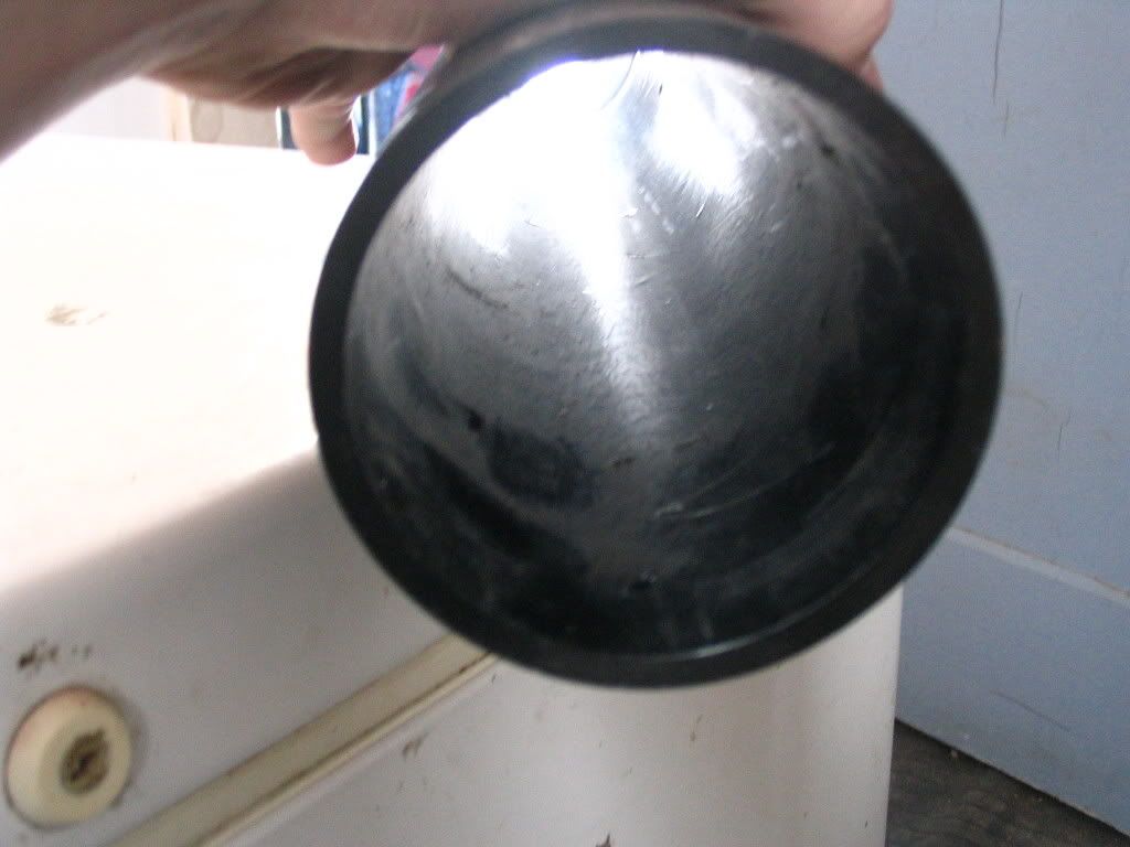

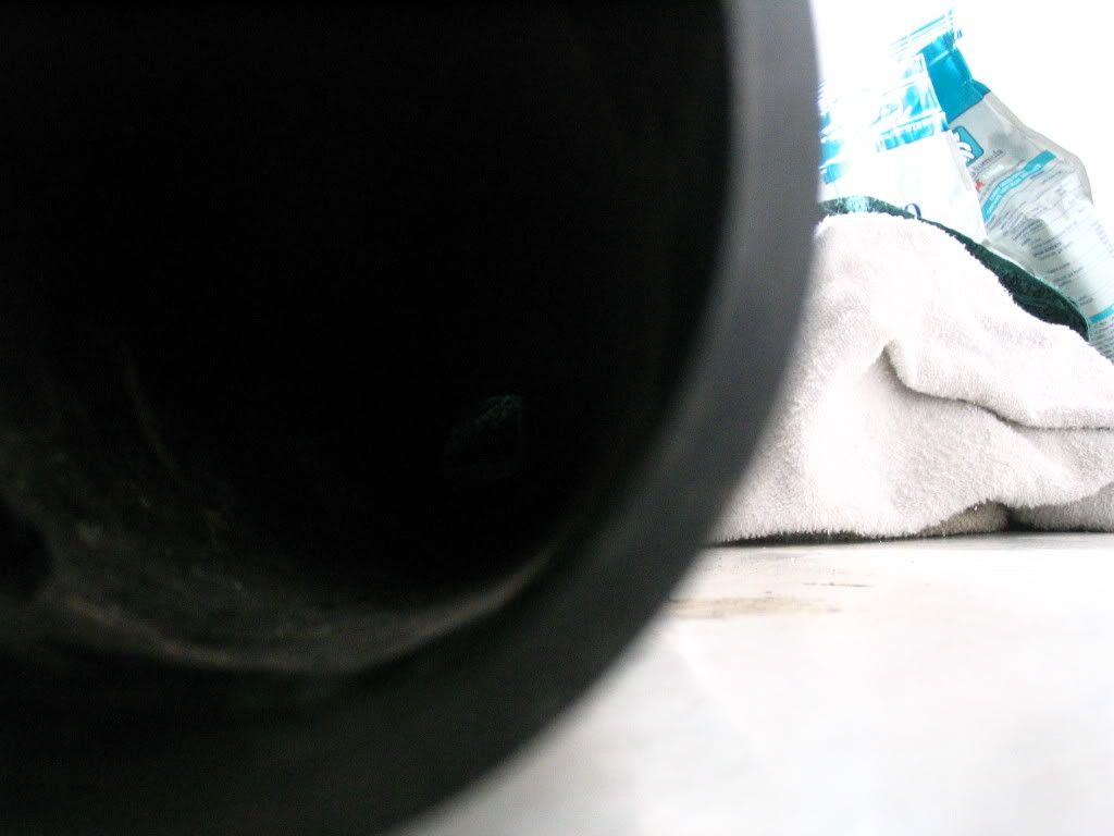

this is the same peice of pipe that i used to make my big cannon out of and i was going to use this pipe to make a smaller one. but can sommeone tell me by looking at it wether it is cellular core or not. it is .5 cm thick

I cannot tell from the pictures... what type of markings does it have on it? If you are unsure, I would not use it.

I can't tell from the pictures either.
Take a good look at the cut end. Does it look like the same material all the way through, or does it look like three layers?

Can you see little bubbles?

Does it say "Cellular Core" or "Cell Core" on the sides?

Try using the Macro feature on your camera to take some higher resolution pictures. As is, I cannot give you a proper answer.

if you are not sure, it's worth the peace of mind to go out and buy some pressure rated pvc.

ok. i am at school right now. i will take some pictures with the macro function on my camera when i get home and post them.

it doesn't have any writing on it :( it is kinda just a piece left over. the writing is on the other part of the pipe and i think it is buried

its black so its abs most abs is cellcore

sorry but i cant get any better photos with my camera (canon power shot A75) i am going to do a pressure test on the pipe tomoro. and i don't see any bubbles
