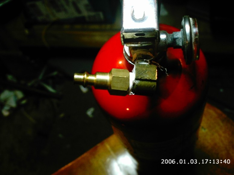

Unread postAuthor: deathtodeer666 » Tue Jan 03, 2006 11:16 pm
I use an old fire extingueser that i modded to connect to a 1/4 quick connect nipple I just blow all the fumes out with a quick blast,I can use it like 4 times before its empty.
  • 0
