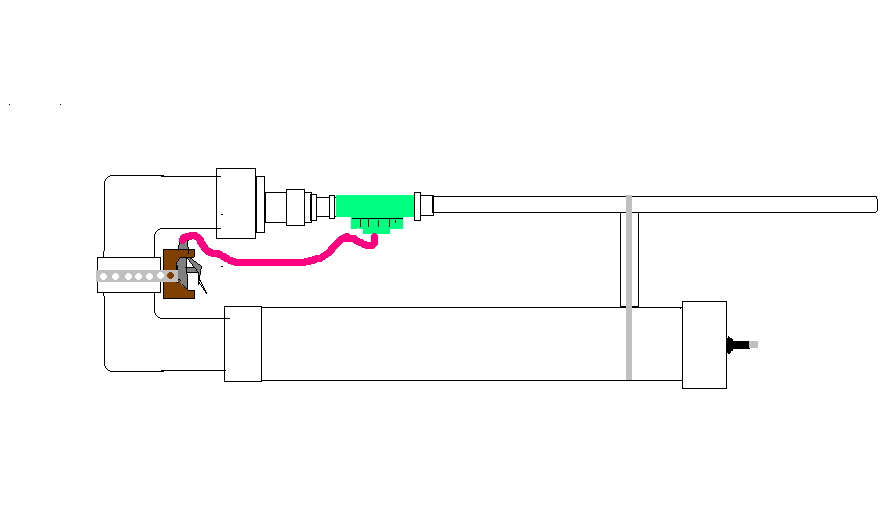

i am building this gun and the spud gun calculator will not work so any ideas on how powerful it may be?

the air chamber is 3 inch, the barrel is one inch, the street elbows are 3 inch the valve is a 1 inch modified sprinkler valve from spudtech

How long are these chambers? It's quit obviously not drawn to scale.

sorry the scanner must have not copied the lengths and diameter of the pipes and fittings when i changed it to jpeg form.
26"x3" air chamber
36"x1" for barrel
pressure being used on average- 40-60 psi

The GGDT results:
The energies with a 25g projectile:
40 PSI: 61 foot/lbs
60 PSI: 87 foot/lbs
.22 lr: ~100-110 foot/lbs (for reference)
Make a barrel extention, buddy... and you'd probably be better off with a 1.25" barrel. (but not by much)
