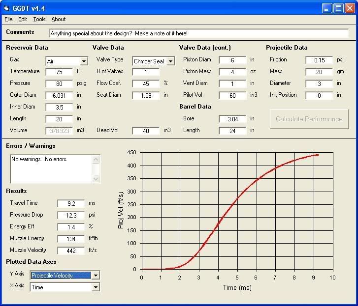

edit: well they do look good enough, with a really good bumper it ought to be okay, my ggdt guesstimate for a pneumatic coaxlie... would empty soda bottles interest you
