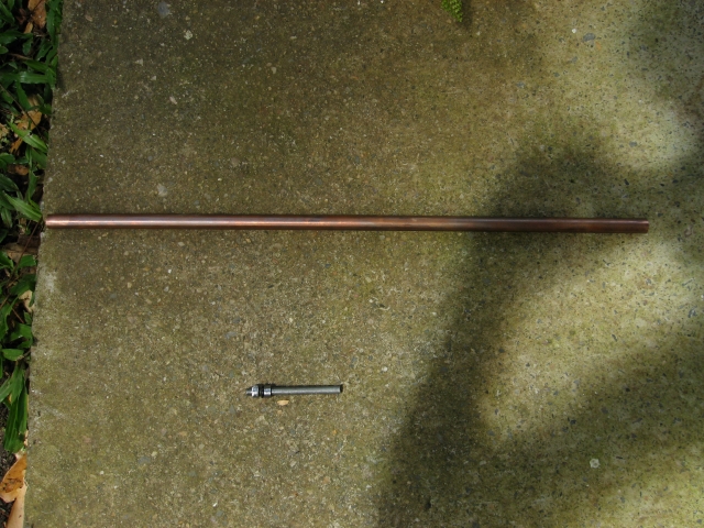

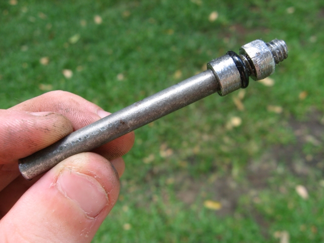

Well lads, I got bored yesty and looked through my box of parts and decided to use what I had to make a ulta high pressure pump. I didn't know if I was able to make the piston so I got a bolt, the O-ring from my shock pump (I'm still yet to buy a o-ring that fits dammit!) and 2 small nuts and did what BTB did, grind the nuts down untill their round and fit the inside of the pipe to make the piston.
I was stoked that it seals perfectly so next week I'm going to get 50cm of threaded stainless rod, and stick the nuts and O ring on there to make the plunger. I'm using comp fittings for this little guy so it should be nice and easy to make.
I know it's only 50cm of 1/2'' but it's all I had lying around, I'm gonna make do with what I have.....but it's close to 3 times the volume of my shocky so I'm happy :D.
  • 0
Don't mind my ugly thumb nail, I got it ripped off in the bench grinder last week :D.

How does it suck more air in to be compressed when you pull the plunger back out? I don't see a check valve. Is it the space the o-ring has to move back and forth that acts as a check valve. Sorry about the n00b question.
I thought all pumps had check valves.

The only check valve will be on the bottom of the pipe inside a Tee to stop the air from rushing back out inside the pump cylinder. This pump uses an O-ring on the piston. The top rounded off nut has a groove so when the plunger is drawn back, the groove in the nut provides a break in seal against the O-ring, so your cylinder is able to re-fill as you draw back.
I hope this has helped :).

I've cheated lads. I was evening up the nuts on my piston head and fooked it. I took a look at the piston out of my shocky and saw it was unscrewable so I took it off and stuck it on the end of my plunger for the homemade pump, works absolutely perfecty so I reckon for the time being I'll be sticking with it :D.

It would be the bottom nut that has the groove to let the air leak in.
I think hard rubber washers are a better choice for the piston head. Less wear on the cylinder. Using metal would require smoothing them very well to avoid damage.
