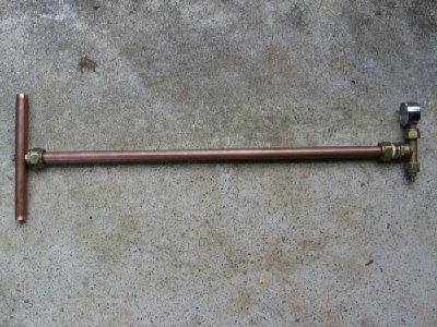

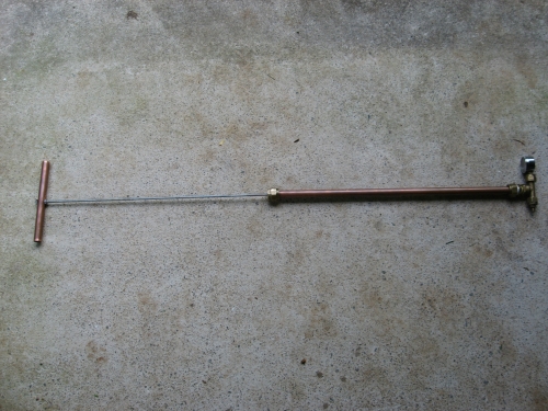

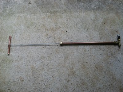

Well I've finally finished my pump. I've only got to hook up a compressor quick connector on the pump and my gun and I'll be all finished. I just used parts that I had and she seems to work beautifully. I've taken her up to 350psi and it was absolutely effortless. I reckon that if I make the staft a bit strong, I could easily take it to 450+ psi.
Cheers to everyone who helped out with the plans. :D

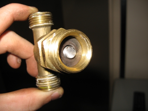

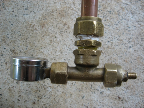

Check valve and assembly

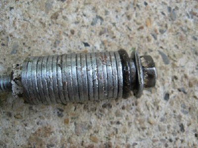

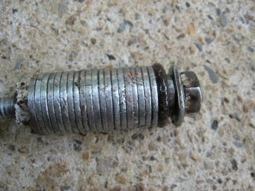

Floating o-ring piston (It looks grubby because I dropped it before I took the pic.
Check valve (uses no glue at all. Just o-rings.)
The pump in all it's glory. I just need to mount it on a floor board for stability.

Unread postAuthor: jackssmirkingrevenge » Thu Feb 28, 2008 1:50 am
looking very good mate, good to see you've finally made it after all the setbacks. Can't wait to see you exploit the power :)

Unread postAuthor: rna_duelers » Thu Feb 28, 2008 1:51 am
She's looking good!Do you think the pressure maximum might change when you add the connector piece?But 350psi easily is awesome man!

Unread postAuthor: Mitchza89 » Thu Feb 28, 2008 1:53 am
Cheers for the comments guys, it really means alot :D. I know it doesn't look as good as Gippedo's (I think thats his name) but eh....you really can't argue with results :D.

Unread postAuthor: Novacastrian » Thu Feb 28, 2008 1:57 am
rna_duelers wrote:But 350psi easily is awesome man!
Not wrong there duelers, seems i could benefit from such a pump (eh JSR).
Great work with this build Mitch, who would have thought that higher pressures than a manufactured pump would be so easy to achieve!
Sorry if i have missed this but what cannon/s do you plan to power with this?

Unread postAuthor: Mitchza89 » Thu Feb 28, 2008 1:59 am
I plan to use my 8mm piston bb gun with it and I'll eventually build a copper marble gun (this won't be for a few months) So I'll get myself make myself a burst disk gun pretty shortly and see how she goes :D.

Unread postAuthor: jackssmirkingrevenge » Thu Feb 28, 2008 2:07 am
rna_duelers wrote:Do you think the pressure maximum might change when you add the connector piece?
If it's behind the check valve, it shouldn't.
Since you can make piston launchers out of materials that can easily take those sort of pressures, definitely! For calibres over 1" you get impressive power from compressor pressures, but as you go lower than that you need nigher pressures to push the envelope. My 6mm launchers were pretty pathetic in the power department before I was aquainted with the joys of shock pumps.

Unread postAuthor: Mitchza89 » Thu Feb 28, 2008 3:46 am
The reason i made this pump was because i like to use large chambers on my guns. the psi drop is a hell of alot less and that means a bit more power. my 8mm was more powerful at 160psi with the large chamber when it was at 300 psi with the small chamber and a shock pump. now ive got a large everything :D if i get bad results, ill never make another gun related thing...ever :D anyway enough drunk random babbles from mitcho for this evening....hahaha

Unread postAuthor: jackssmirkingrevenge » Thu Feb 28, 2008 3:52 am
This would be perfect to fill a chamber for a 3/4" launcher, you'll have one hell of a marble gun, and I'd definitely look into making an effective suppressor if you have sensitive neighbours.

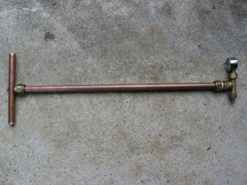

Unread postAuthor: Mitchza89 » Thu Feb 28, 2008 7:05 am
well im gonna attempt to try and come up with the parts list after a dozen beers. this will fail terribly.
parts:
-3/4'' compression end cap
-3/4'' compression to male bsp
-1m 1/4'' threaded rod
-21x1/4'' washers (20 for the piston and 1 one the back board for the o-ring to sit against.
-3/8'' or so washer to fit inside the compression to male bsp (grinding down may be required)
-5x1/4'' nuts
medium guage 50mm long spring (as seen in my glueless check valve thread)
-bolt to fit snuggly inside the spring but big enough to fit in the 3/8'' washer
-600mm+ 3/4'' type B copper (chamber)
-200mm 3/4'' type B copper (handle)
-3/4'' m/f/m tee or an all female T depending on how long the spring is
-no' 10 size O-ring
-whatever will fit the bolt that compresses against the washer
Thats about all I can suggest. I couldn't be bothered getting an NPT to BSP converter nipple for the guage to go into the tee, so I used the m/f/m nipple and compression fitting'ed the guage in. At 400psi, it's got no sign of budging. All i can suggest is going to a hardware shop and use the knowledge you have gained by looking at other pumps and mine on spudfiles to find what ya need. thats what i did mate.
